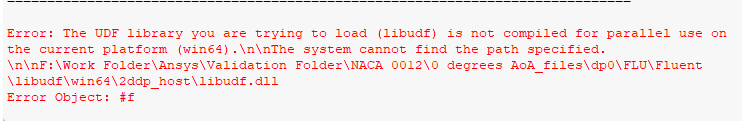

SubscriberI have been trying to work on morphing airfoil for the past few months and I was attempting to perform CFD simulation over a NACA 0012 airfoil and then perform it on an asymmetrical airfoil. However, for NACA 0012 airfoil I managed to acquire a UDF code in order to perform unsteady morphing upon the airfoil.
But the problem I am facing it is that, whenever I try to compile this UDF file it shows that the UDF i am trying to load is not compatible to be used as a parallel to the current platform. The following pictures show the error messages

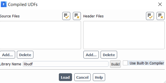

May 12, 2021 at 7:08 amKeyur Kanade
Ansys EmployeeCan you please check if you can use 2020R2 and use in built compiler.
48.2.14. Compiled UDFs Dialog Box (ansys.com)
Regards Keyur
