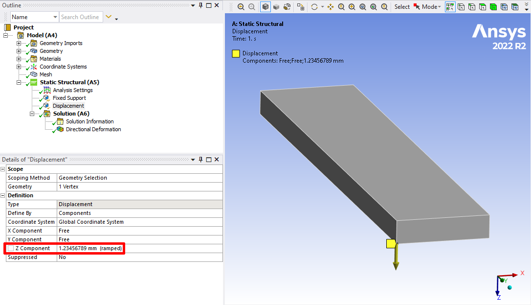

      I have a little example with simple beam bending. One side is clamped, on the other side a single node undergoes a z-displacement of 1.23456789 mm:
      After calculation, the maximum displacement at this node is 1.234567881 only. If you read this displacement with Python console inside Mechanical you get also a value of 1.23456788063. This is exactly the value that you get if you store 1.23456789 in a single-precision floating point number (can be tried out with any programming language). This shows me that Ansys Mechanical works internally with single-precision numbers.

      • ThomasDD
        It’s not about the number of decimal places shown, that’s already the maximum (10). It is about the fact that Mechanical does not handle and display exact numbers because it only works with low precision floating point numbers.
        Reading the RST file with Ansys Classic provides the exact value: 1.234567890
        In Mechanical I get a different value: 1.234567881 (as only 4 byte variables are used to store the floating point numbers)
        I display 10 digits in both cases.

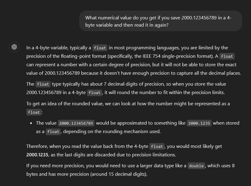

        The difference becomes much more serious if you have problems with large rigid body displacements. If I push the clamping down by 2000 mm on one side and the free side by 2000.123456789 mm, I get the following displacement at the free end:
        • Ansys Workbench: 2000.12341309 mm (floating point error, a single precision float can only display the first 8 digits correctly, the last digits are a faulty “noise”)
        • Ansys Classic: 2000.123456789 mm (that is the exact value, Ansys Classic works with double precision floats)
        • PyMAPDL-Reader: 2000.123456789 mm (that is the exact value, PyMAPDL-Reader works with double precision floats)
        … based on the same RST file.
        Ask ChatGPT for that: “What numerical value do you get if you save 2000.123456789 in a 4-byte variable and then read it in again?”
