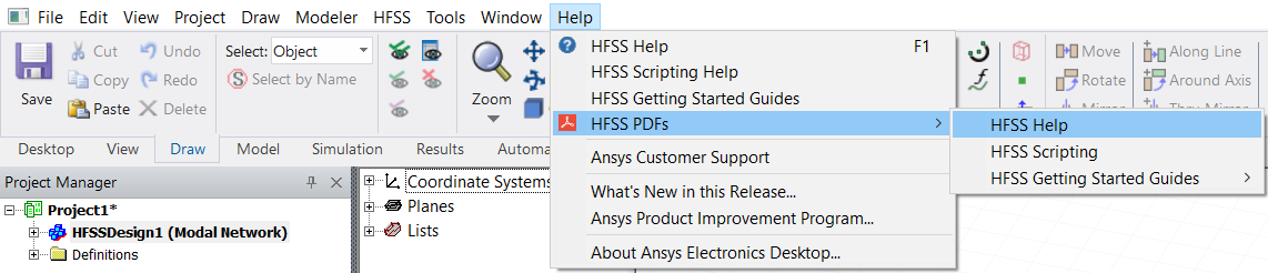

December 26, 2021 at 5:58 amhoyyoth
SubscriberHi Pmunga Thank you very much.
If you don't mind could you please share the link for HFSS help documnet.
Regards
HARI
