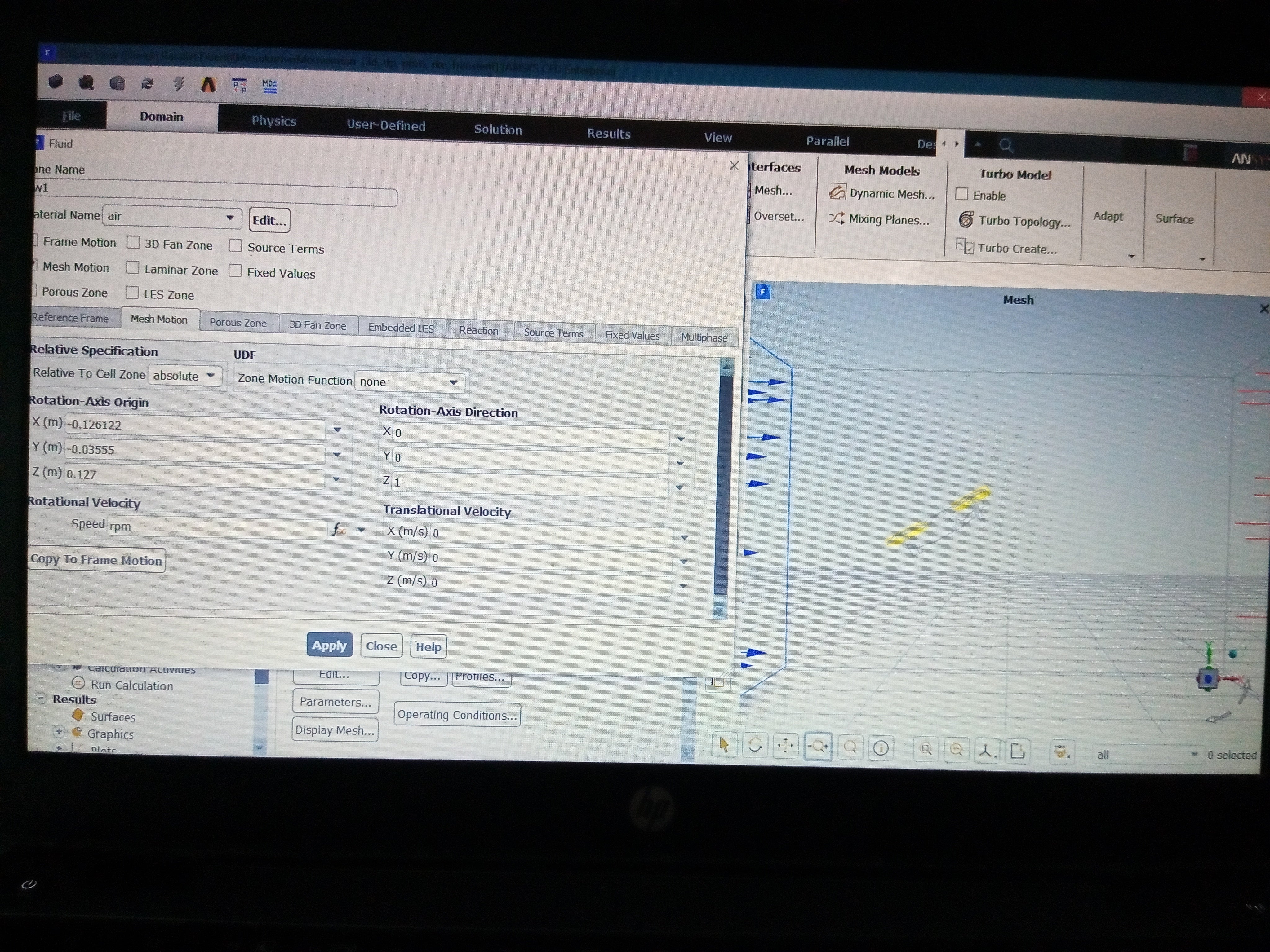

I've designed a drone with propellers and I'm simulating it in fluent.
Entire model is tilted at 30deg.
What should be the rotational axis direction inorder to spin propellers in fluent
July 20, 2021 at 12:32 pmRob
Forum ModeratorIt'll be a function of +y and -x to suit the 30 degree tilt. We use the right hand rule to then determine whether the rotation speed is + or -
July 20, 2021 at 1:02 pmKarthik Remella
AdministratorHello The easiest way to move forward would be to reorient the mesh by rotating it by 30 degs so that your axis of rotation points along the y-axis. You can then use (0, 1, 0) if you wish an anti-clockwise rotation in the XZ plane.
