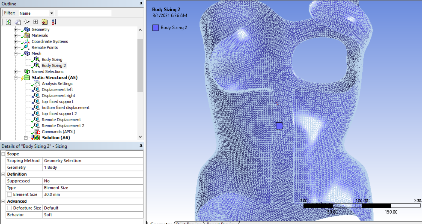

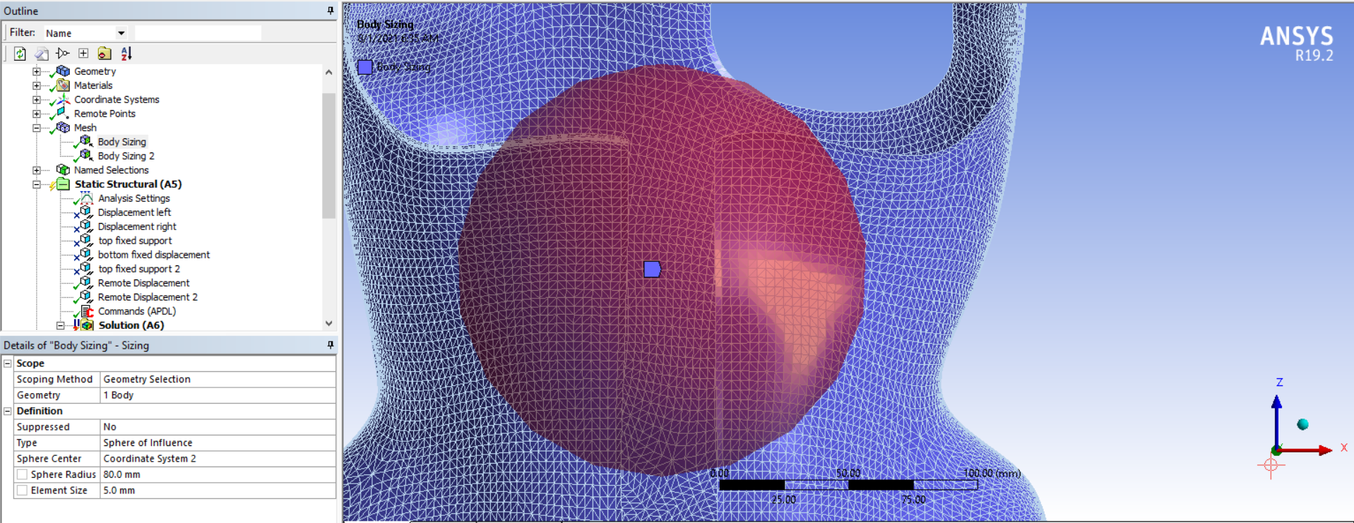

      nHere is the mesh: nI actually tried using Sphere of Influence to reduce mesh size in that area to 5.0mm before solving:nI have another mesh called Body Sizing 2 for the whole brace which is 30mm:nn

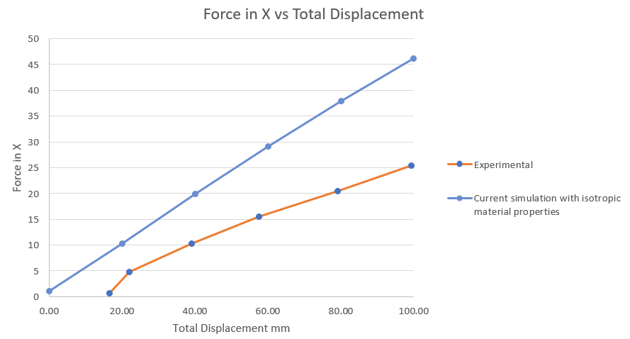

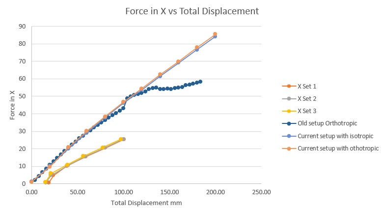

      ! I solved the file you uploaded for isotropic and orthotropic materials. nThere isn't much difference to my old setup very early in this post. Here's the graph comparison:nn
      nIt's not clear from the legend which data is experimental measurement and which is simulation.nPlease just show two curves, one experimental and one with the simulation results.nThe simulation I provided only went to 100 mm.nIf you want to make the model output closer to experimental values, adjust the thickness of the shell elements.nIt doesn't make sense for experimental data to start with a non-zero displacement at zero force.n
    • yappyap
      nHere is the experimental and simulation curve:nnAs mentioned before, the experimental curve does not start at zero displacement due to existing weight-holder at the pulley. The force is minimal but not zero. We have not gotten a chance to head back to the lab to re-conduct the experiment to suspend the brace from the ceiling like you suggested hence we can only work with what we have now.nThe real life brace is 3mm in thickness thus the thickness of the brace in the simulation was set to 3mm too.nn
