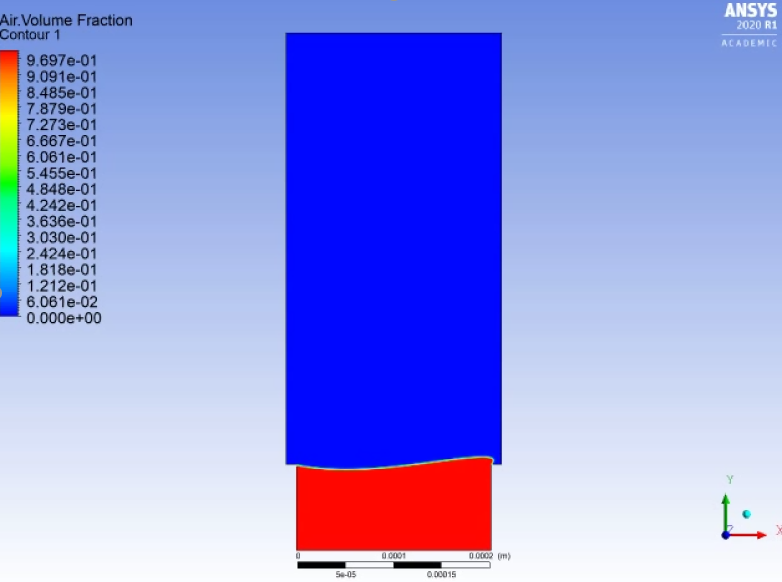

SubscriberThank you, Kremell. nFor my first picture, I didn't use either one model. When I use either CSS or CSF, the parasitic current always exist and the water penetrate the interface and get into the air region. However, when I only set up a constant surface tension without these models, it works well. Thus, I wonder if it is necessary to enable one of the model to say modelling the surface tension. The guide seems to say that it is necessary so i am confused.nAlso, is what you mean the type of gird the shape of the mesh cell?.BestnJianhuanAugust 5, 2020 at 1:11 amKarthik Remella

SubscriberThank you so much, KarthiknHere is my dimension and how I set it up. Water initially fill up the upper part and air is in the groove. Without the CSS or CSF, it converges (1e-3) very well. After a few time step, It takes just around 5 trails then converges. The Courant number is around 0.9 and seems decreases slowly.n
nWith CSF, the Courant number is like around 90. It takes much longer to converge.n
nI just tried to set the surface tension coefficient to be none. And I run it for the same time, then I got a similar result (not sure if the same). nI am confused how the interface sustains if no surface tension is modeled.nBestnJianhuan

AdministratorHello,nCan you please try and reduce the time-step in your CSF simulation? This would reduce your Courant number in the simultion.nPlease let me know if this works.nThanks.nKarthiknAugust 6, 2020 at 10:45 pmucla278924569
SubscriberTime step was 1e-6 and i ran the calculation for 20 steps (2e-5 s). I changed to 1e-8 and then run it for ~1700 steps (1.7e-5 s). Volume fraction, stream function and velocity vector are shown below.nThe weird current did not happen on the interface so far, but the velocity field near the interface is quite strange and velocity there is quite big compared to the case without CSF.Thanks for your help, KarthiknBestnJianhuann

AdministratorThese are spurious parasitic currents and are quite common in VoF models. One way is to reduce these currents is to reduce the time-step. There are of course other ways of reducing these. I'd strongly recommend looking them up in the literature if you wish to learn more. nI hope this helps.nThanks.nKarthiknAugust 7, 2020 at 5:35 amAmine Ben Hadj Ali
Ansys EmployeeWhat you can do apart from reducing time step is to use Viscous Dissipation (look for that under beta feature). It might (only might not should) as parasitic currents will always be there: in 2D more than in 3D. Based on qucik estimation your time step size cannot be larger than 1e-8[s] even lower.nViewing 8 reply threads- The topic ‘what CSF and CSS model options do in multiphase modeling?’ is closed to new replies.
