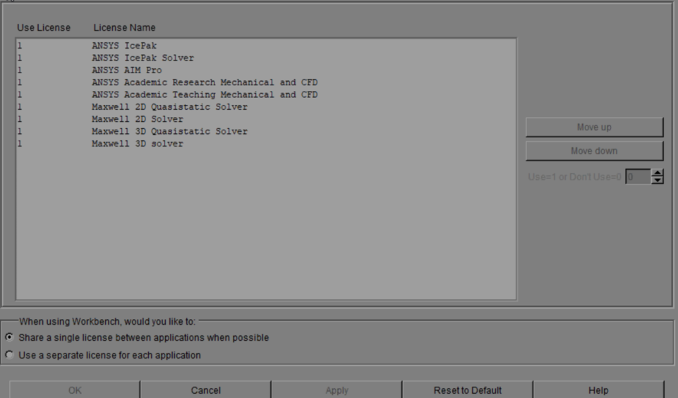

Unfortunately my institute does not have LS-DYNA, so i am trying to understand the capabilities of the solvers.
Can you please advise what each of the solvers shown below can be used for.
January 18, 2021 at 1:16 pmKarthik Remella
AdministratorHi,nHere is where you can find some information about the following packages.nIcePak: https://www.ansys.com/products/electronics/ansys-icepaknAIM: https://www.ansys.com/-/media/Ansys/corporate/resourcelibrary/brochure/ansys-aim-brochure.pdfnMaxwell: https://www.ansys.com/products/electronics/ansys-maxwellnI hope this provides you with an overview.nKarthiknJanuary 18, 2021 at 1:55 pmMickMack
SubscribernnThank you for that information.nnCould you please confirm if i am correct to say that, Icepak is for fluid analysis and maxwell is for electromagnetic analysis?.It is a structural solution which i require. Would AIM be suitable for this and does it analyse non-linear or dynamic effects?.Also i note in the properties tab of my static structural analysis it states that the solver is Mechanical APDL, can this analyse non-linear behaviour and why was it not on the list of licenses above, or is it contained within one of those shown in my screenshot?nJanuary 18, 2021 at 1:59 pmKarthik Remella
AdministratorYes, you are correct about IcePak & Maxwell.nRegarding modeling non-linear dynamic effects, you can use Ansys Mechanical (Static and Transient Structural). Mechanical APDL is the backend used by Ansys Mechanical package. I overlooked this in your screenshot. You do have the license for Mechanical.nThank you.nKarthiknnViewing 3 reply threads- The topic ‘What are the functions of the various solvers?’ is closed to new replies.
