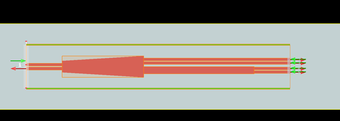

      Hi I am trying to simualate the structure given below, but i am not able to get a good mode at the port and hence it is showing error. Can you please check the placement of the port?
    • Guilin Sun
      When more than one waveguides are included in the port, due to mode degeneracy, you may not be able to find the case that each waveguide supports a specified mode. You will need to add a port for each waveguide, and make the port span as large as possible without creating mode from the adjacent waveguide. The port cannot just have the same size as the waveguide core, since the mode has tails. You may also need to confrim the mode is what you desire, by visualizing the mode profile. Or you can use "user select" and calculate the mode, and just choose the one that you expect.
      If this is a slot waveguide, you just only need to increase the port span to find the slot mode.
      In any case, you will need to justify the mode is correct.

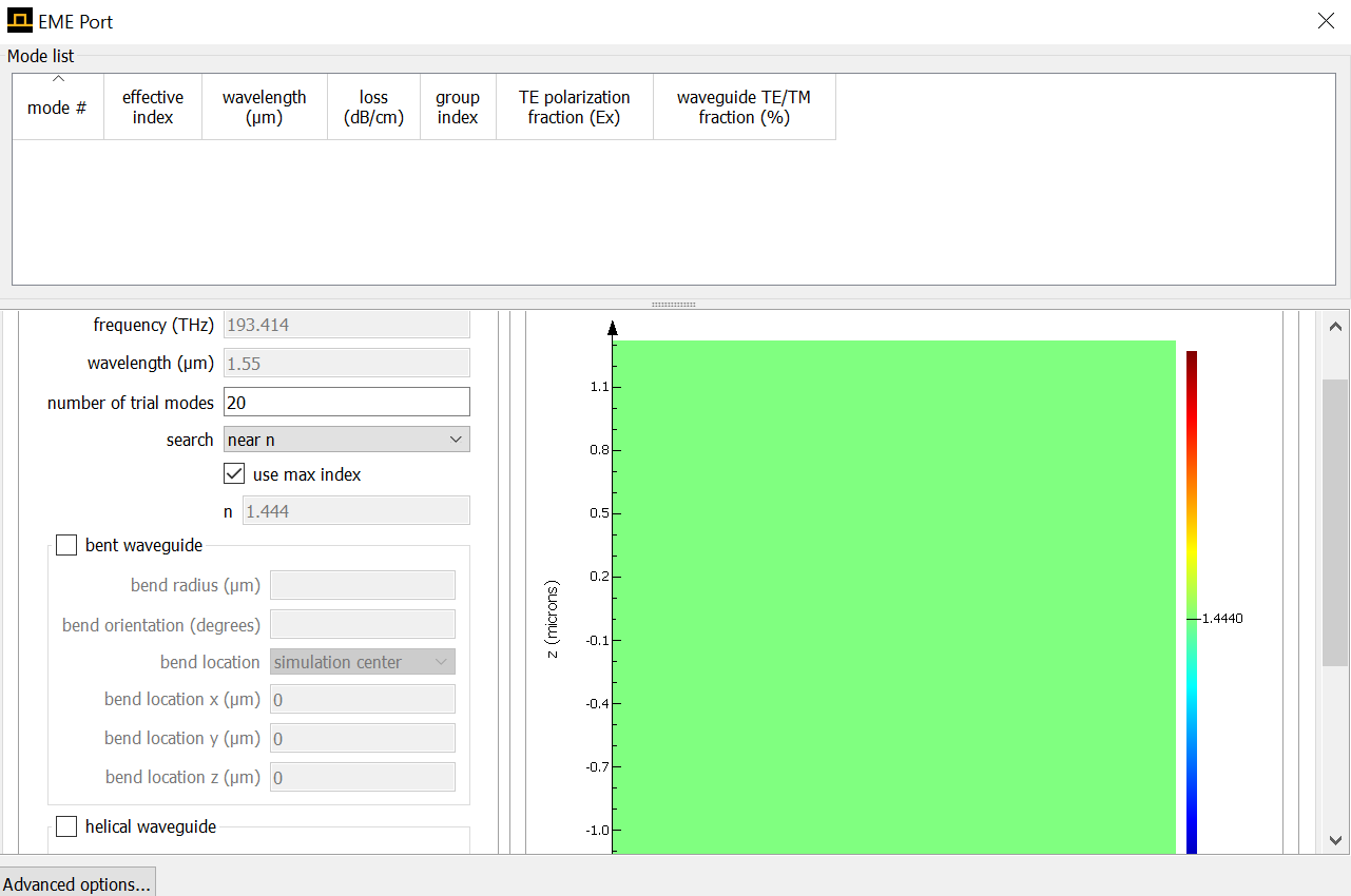

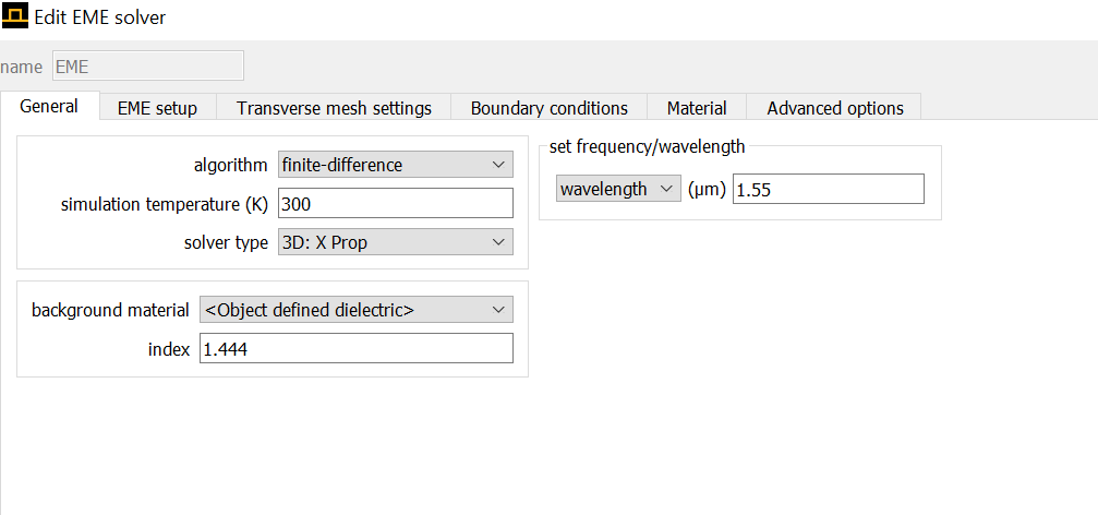

      Yes , this is an EME simulation, i did update the port and other parameters with respect to the sample given in the website. Unfortunately, it is not taking in the index
      value
    • minusunny
      This is what I obtained when I did eigen solver analysis of the same single-mode waveguide

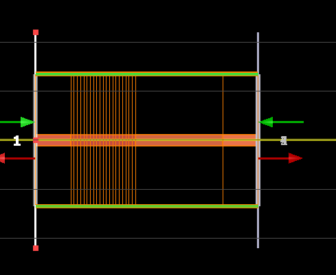

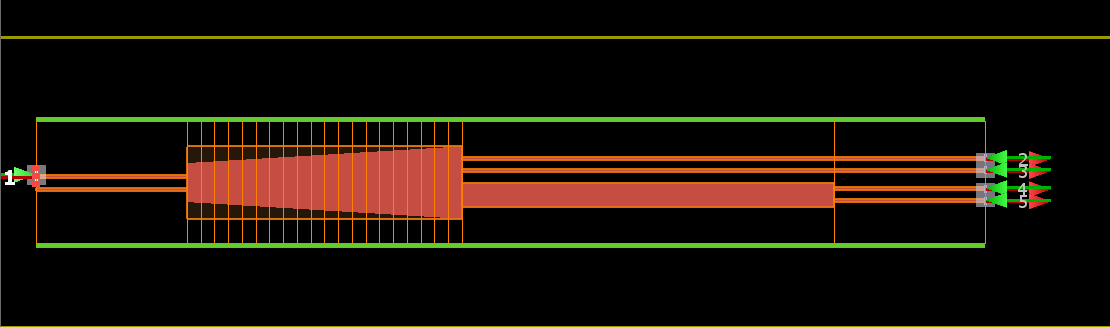

      The index minitor data can be viewed after simulation.
      Please try this example. Make sure the  monitor is inside the simulation region.
