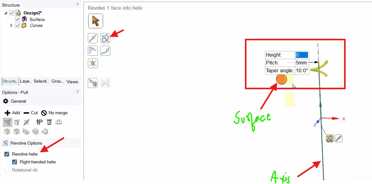

December 9, 2025 at 5:28 am
mohan.urs
Ansys EmployeeHey,
Are you creating the coil manually or through a script ?Â
To create it manually you can use revolve pull as below -Â
More information of this can be accessed here - Revolving Helices
