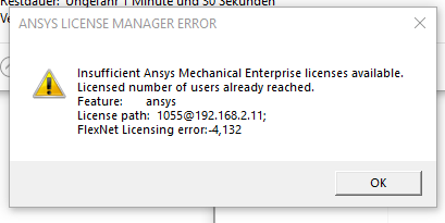

      If all available licenses are checked out, it is still possible to start ANSYS Mechanical in Read-only-Mode. This can be absolutely sufficient and very helpfull if one wants just to look up a result or check a setting in a previous simulation.
      Previously, I worked with ANSYS 18.2 and ANSYS 2020R2 and frequently used this option.

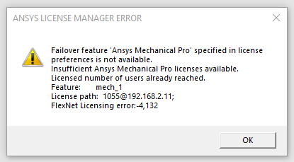

      Usually, I got once one of the following error messages, clicked “OK” and could open Mechanical in Read-only-Mode.
      Since two weeks I use ANSYS 2023R2 and have found that the error message is prompted for six times in this version. So I have to click on “OK” for six times. Also, there is a lag of several seconds between each promted error messages. Only after I clicked away all of them, Mechanical is started Read-Only-Mode. This behaviour is really annoying and time consuming!
      Thus, I wonder if somebody has made the same experience and maybe found any kind of solution.
      Thank you in advance!

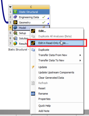

      Hi Viktor,
      Did you try to open the model in read-only mode by using the below option?
      Thanks,
      Akshay Maniyar
    • Viktor Merkel
      Hello Akshay,
      your solution works! Mechanical starts directly without any error messages!
      Never paid attention to this option in the previous versions of ANSYS! ?
      Thanks a lot!
