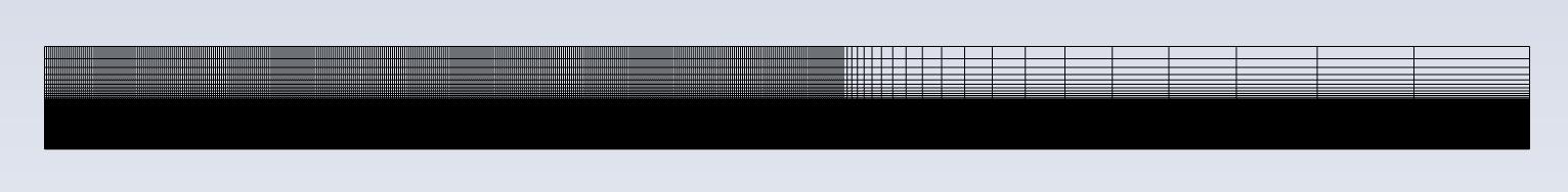

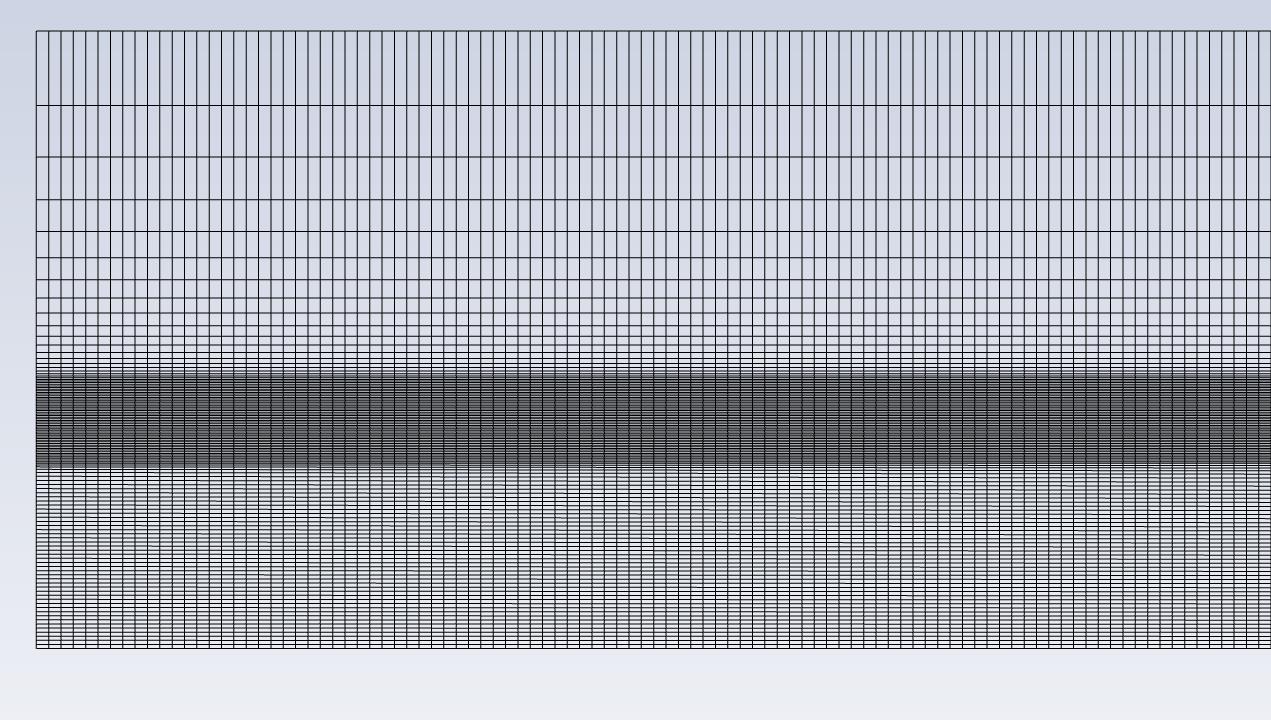

I would like to have some help with my study case on Fluent. I'm simulating wave propagation in a 2D wave flume model using VOF with open channel model, generating Stokes second order waves with H = 5 cm, T = 0.86 s (L = 1.07 m) and a water depth of 27.5 cm. I'm using a mesh refinement on the water surface envelope with 80 CPL-X direction, 20 CPH - Y direction and a time-step of T/200. The CFL condition is around 0.6.Â
The problem is that the waves are losing energy (height) during the propagation phenomena in the domain. I'm analyzing the surface elevation at 0.5 m, 1 m, 2 m, 3 m and 6 m from the inlet. The results are presented in the attached file.Â

Ansys EmployeeFor open channel flow you need to take care about domain extents and here you need to be very generous: Above the free surface you need at least 1.5 wavelength. At least 30-40 cells per wave height and length are required to reduce diffusion and dispersion errors and a time step to around T/100 or T/200. Also add a sort of sponge towards the outlet (coarse mesh)Â and beach to reduce reflection.

SubscriberMy domain is 5 m length with regular mesh, 5 m length with a coarse mesh and 0.75 m height (I will try to increase it for 1.5 wavelengths, but since I set-up the upper boundary as pressure outlet with 0 gauge pressure, should it has so much influence?). I also refined the water zone below the water surface since in the future I will also have an obstacle there. In terms of the beach, would you suggest a numerical beach or it needs to be a geometrical beach?Â

Ansys EmployeeSet up the top boundary to be symmetric if you are extending into the height (1.5 times wavelength is really a minimum). It might be you are getting some reversal flow of air from the top if pressure outlet is near the free surface.
I am talking about numerical beach + sponge coarse cell zone towards the outlet.

I already set up the top boundary as symmetric and increase the height of the domain to 2 times the wavelength. The same level of damping is obtained. I also performed some simulations with a different number of cells per wavelength (50 and 70) and number of cells per wave height (20 and 30). The differences between the analysis are negligible. Do you have some more ideas about the origin of it?Â
