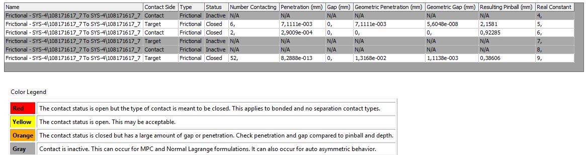

      Can anyone know to describe  the next table:
      Because for the first pair, the status of the contact is inactive but the target is closed, I am so confused.
      Contacts in Mechanical have a Behavior setting.
      In Mechanical you pick one face to be the Contact side and another face to be the Target side of the pair that make up one contact definition.
      Behavior can be Symmetric, Asymmetric or Auto Asymmetric.
      Asymmetric gives you one set of elements: the Contact elements on the surface you picked for the Contact side, and Target elements on the surface you picked for the Target side.
      Symmetric creates a second set of elements, but with the Contact and Target sides switched and both sets of elements are checked by the solver as it computes the contact. This adds a little to the model size and takes a little longer to solve, but has a better chance of avoiding excessive penetration.
      Auto Asymmetric was used in your example where the Solver is given a Symmetric pair of contacts and picks one of them to use, and makes the other Inactive.
