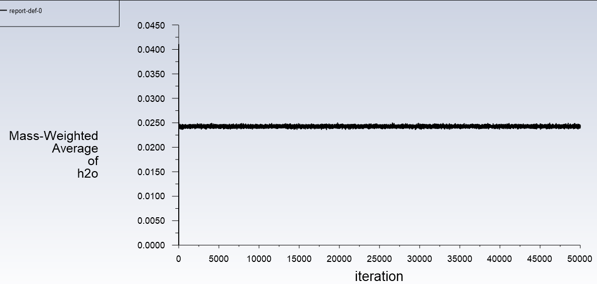

    • RajasekarK123
      No sir, i am getting fine atomization with 0.97gps itself. Anyway can you please comment on the convergence of my problem? because after 50000 iterations also its in the particular deviation. shall i consider this as converged.nn

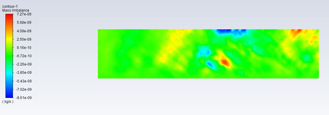

    • DrAmine
      Looks fine. What about global mass imbalances and other reports?n
    • RajasekarK123
      n

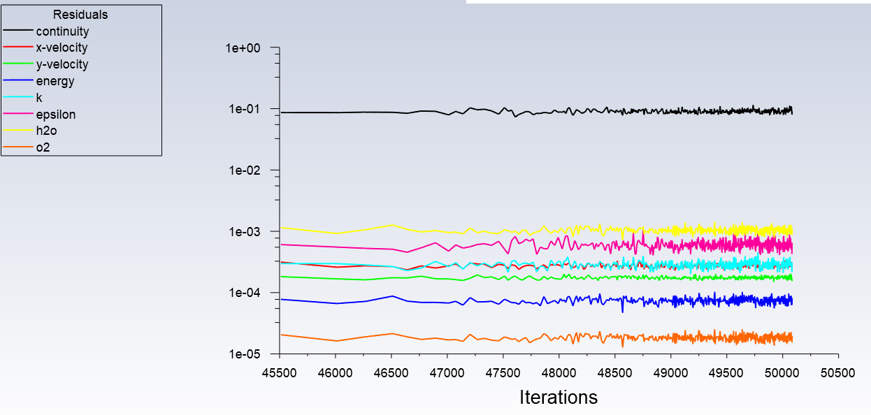

    • RajasekarK123
      Residualsnn

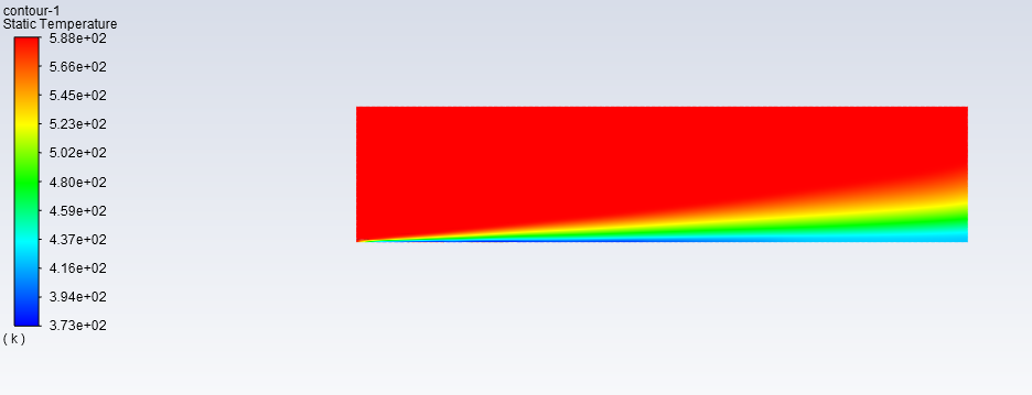

      How does the flow field look? Remember, we use residuals, mass balance and monitors to judge convergence. Sometimes one or more of the metrics won't converge then we have to use the results to understand why: it's not uncommon for residuals to be as you're seeing because of some transient in the flow field. n
    • RajasekarK123
      Temperature fieldn
      And how does that compare to what you're expecting? n
