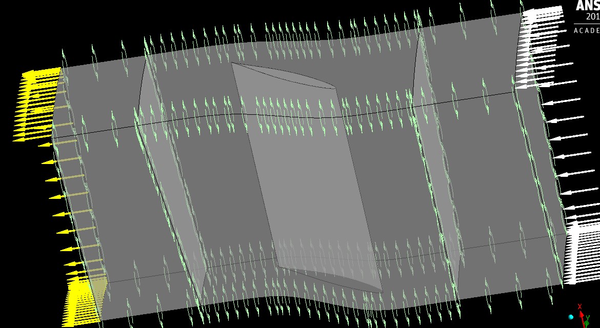

      I'm trying to do flow analysis on the rotor with the tip clearance at the shroud. when I use no-slip wall it says memory allocated not sufficient, when I use counter-rotating wall it shows following error. I have done the meshing in turbogrid.
       ERROR #002100080 has occurred in subroutine CHECK_NORMV.           |
       | Message:                                                           |
       | The specified velocity vector on the boundary patch                |
       |  R1 Shroud                                                         |
       | has a significant normal component at one or more faces. One of    |
       | these face locations is                                            |
       |  (x,y,z) = ( 4.98395E-01, 4.00300E-02, 4.99807E-02).               |
       | The angle between the specified velocity and the element surface is|
       |   28.521 degrees at this face. This is considered an error because |
       | it implies that the mesh is moving.  The following are possible    |
       | reasons for the error message:                                     |
       | 1. There is a setup error; for example, an incorrect axis of       |
       |    rotation.                                                       |
       | 2. There may be a meshing problem; for example, the nodes on a     |
       |    rotating surface might not lie on the surface of revolution.    |
       | 3. The boundary is curved and the mesh is very coarse. In this     |
       |    case, you may modify the tolerance by increasing the            |
       |    expert parameter 'tangential vector tolerance wall'             |
       |    from its default of 20 degrees.
