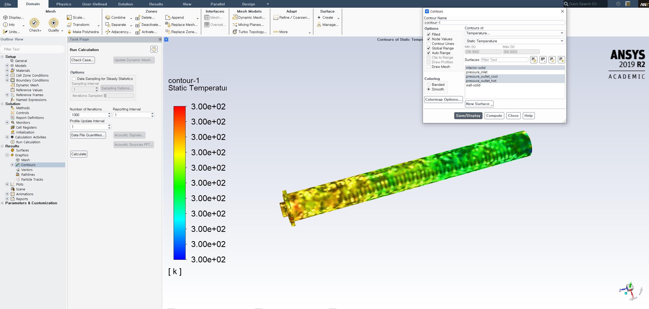

      I try to make vortex tube, but there are no temperature separate.
      i setting
      energy- on
      viscous - realiazable k-e / enhanced wall motion
      pressure inlet - gauge total pressure = 9bar, supersonic / initial gauge pressure = 4bar . 300k
      pressure outlet hot - 2bar
      pressure outlet cool - 1bar
      wall solid - convection , heat transfer coefficient = 100, free stream temperature = 300k
      method - simple
      Those are all i setting. but it doesn't work.

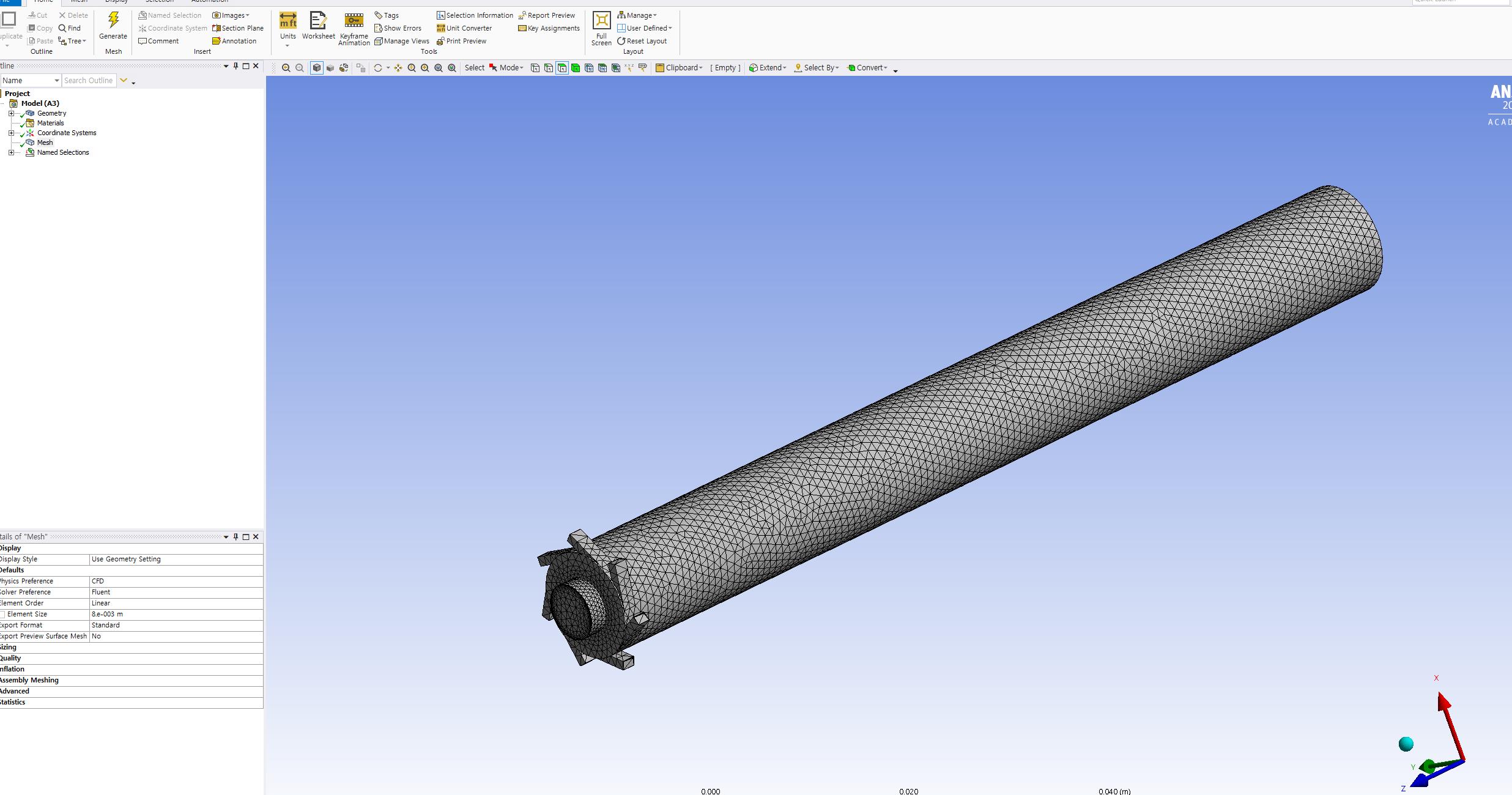

      it has 190000 meshes!
