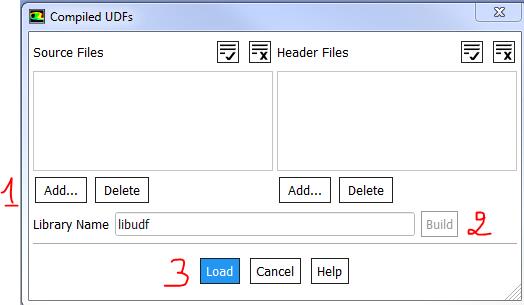

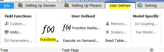

To compile an UDF in Fluent, follow these instructions:
- In User Defined, click on Functions and Compiled
- Then click on Add and choose the file (in c. format). Click on Build, and Then Load it.
Maxime
