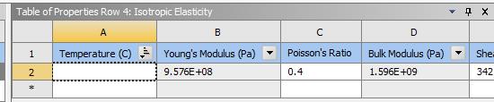

SubscriberI am trying to model a laminated glass consisting of 2 panes and PVB interlayer in-between. The interlayer has a viscoelastic behavior and I have the experimental results. I have already defined the Shear Modulus (time and temperature dependent) [Fig 1].Â
But this is not enough because the model cannot be solved due to the error in Fig 2. To make it work, despite Shear modulus, I should define either Young's modulus or Poisson's ratio. But I don't know which Properties from the Toolbox should I chose to use in order to correctly describe visco-elastic behavior.
Any suggestions?

SubscriberHi Jon,
Add Isotropic Elasticity and enter a value for Young's Modulus and Poisson's Ratio.

Inserting Isotropic Elasticity is exactly the reason why I had to seek for help here. Since I defined the shear modulus on "Shear Data - Viscoelastic", it means that now I only need to define the Poisson's Ratio because Elastic moduli (E) will change by how the shear modulus (G) changes. However, at "Isotropic Elasticity" it is mandatory to put Poisson's ratio and E (or G) [Fig 3] 1) If I defined G once why should I do it again?
However, additionally to "Shear-Data Viscoelastic" I have also tried to define E and Poisson's ratio at "Isotropic Elasticity" as you suggested as well. With this two problems arise:
I) If I increase the loading by 10, the displacement will be increased by 10 as well, typical for isotropic behavior. And this makes me think that viscoelasticity is not being considered
II) I remove the data at "Shear Data - Viscoelastic" and I get the same results as when the data was there. Still, this means that they are not being taken into consideration

SubscriberHi Jon,
Viscoelasticity has time as a variable in the computation of displacement, while elasticity is the instantaneous response. If you simulate 100 seconds when load=1, and you compare the displacement results at 100 seconds with the load=10, you should not have a ratio of 10Â at t=100Â due to the exponential behavior of the viscoelastic material.

Ansys EmployeeJonsys,
I'll give you a brief overview of viscoelasticity so it'll answer your questions: viscoelastic bevahior has a viscous (time-dependent) component acting upon the elastic (time independent) component. The elastic component can either linear (linear elasticity) or nonlinear elastic (hyperelastic). The viscous component is usually modelled using Prony series which uses the normalized shear moduli and the characteristic time constants (they come in pairs) as the material properties.
When you input viscoelastic shear data, you'll need to perform curve fitting to calculate the Prony series constants to complete the definition. After you do that, you get the normalized shear moduli and their corresponding time constants. Since the moduli are normalized you still need to define an elastic component for the viscous component to act upon.
In the example model that you showed above, when the isotropic elasticity is not defined the material had no stiffness behavior associated with it which is why it threw the error. When you defined isotropic elasticity properties and defined 'shear data - viscoelasticity', the Prony constants are missing as you haven't performed curve-fitting yet so there is no viscous behavior associated with it.

For one example I have Prony Shear Relaxation parameters, therefore I implemented the way that you said and everything works well for a certain temperature.
1) But for other examples I do not have Prony series parameters, therefore, I should do the curve fitting as you suggested but what option should be used for curve fitting? I could not manage to do that.
2) I want to see the behavior of the material while the temperature is changing, therefore I can define the Isotropic Elasticity behavior dependant on temperature [Fig 4]. But I don't know how to get output dependant on temperature; Is there anything that I should add at the Analysis Settings? Do you have any suggestions?

Regarding your questions
1) You should have the stress relaxation data (stress vs time) that you input under 'Shear data-viscoelastic'. After you input the data, select Prony Shear Relaxation under Viscoelastic. This should place a Curve-fitting object since the data is available. When you right-click on Curve-fitting you should get an option to solve curve fit. You'll need to pick the number of terms under Prony shear relaxation, this is a trial and error approach so start with 1 term and increase them only if you're unable to find a good fit. This step can be tricky as you're dealing with nonlinear regression based optimization. You'll need to change the initial seed values to improve the quality of curve-fit. This involves a bit of learning curve so I'd recommend that you spend some time.
2) If you have defined temperature dependent Young's modulus and apply a thermal load in Mechanical, the change in temperature must change the material stiffness accordingly and this should reflect in your results. You don't need to turn anything ON/OFF under Analysis settings.
