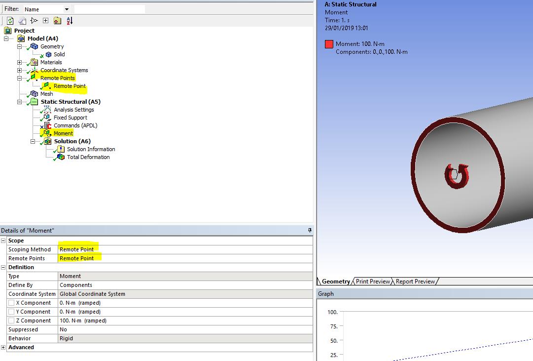

      That is correct (3D elements do not have rotation dof).
      Typically one uses constraint equations to apply those (say CERIG or RBE3).
      See this video (below) where they apply a remote force.
      To apply a moment (100 Nm) to a remote point called remotepone (under details, definition, and APDL name) you need to probably insert something like this as a command snippet (F command):
      F,remotepone,MX,100
       Or just use a moment and pick that remote point (See below)
