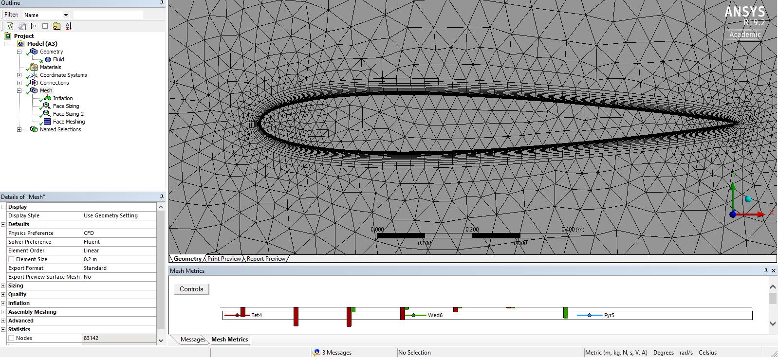

      I am having this problem for like 2 months and after countless of youtube tutorials and meshing and fluent guidebook i still cant find what the problem is.
      So i have to calculate the cl and cd on 3 different naca profiles ( NACA0012, NACA0015, NACA4412) for 8 different aoa. My analysis is 3d.

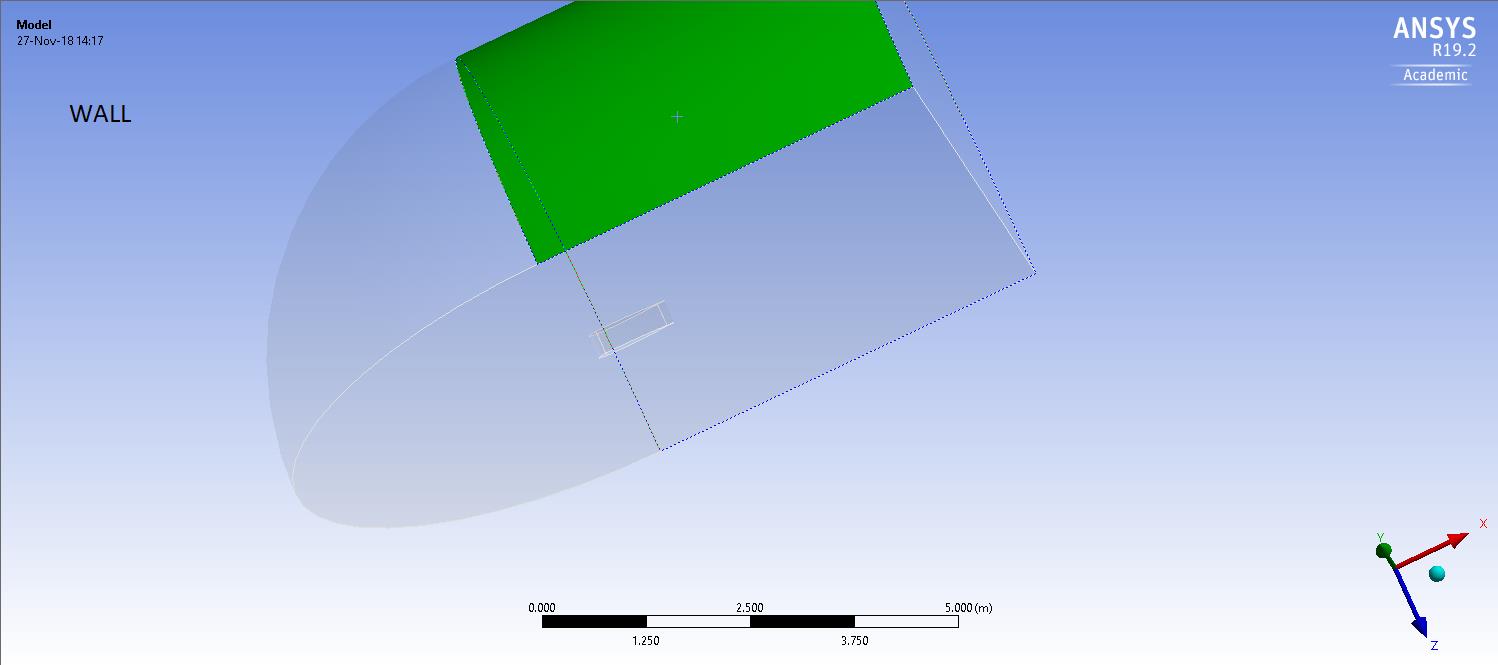

      The big problem is that WHATEVER i do to the mesh and whichever model i try to solve it the cl gives me a number of somehting like 0.05 which ofc is undeniably low. I change the aoa from the boundary conditions x=vcosθ, y=vsinθ, cl-->x=-sinθ y=cosθ and cd the oppoisite without minus.
      Till now i ve tried different kinds of meshing options different methods but i cant solve it..
      I have added some photos of the mesh to help you get a glimpse of what i am talking about.
      Btw i am using Ansys 19.2 ACADEMIC and the programm is ANSYS FLUENT.
      MATERIAL=WATER
      SPEED=4m/s
      BOUNDARY CONDITIONS= COMPONENTS,ABSOLUTE
      MODEL= K-OMEGA SST
      INLET=INLET VELOCITY
      OUTLET=PRESSURE OUTLET
      AIRFOIL=WALL
      NEAR SIDE=SYMMETRY
      FAR SIDE= WALL
      Thank you in advance
      Kostas
      P.s If you need more photos with other infos just tell me so

      Can you please insert more images of the mesh. Please insert some zoomed images to check the mesh.
      Also did you have a good convergence? Please check. Please share set up images.

      Please share where the boundary conditions are applied: is not clear from screenshots

      So just to exclude some things yiu don't think that the mesh has something to do with it
    • Amine Ben Hadj Ali
      On first sight not really: off-course one creates a much better mesh.
    • Keyur Kanade
      Mesh looks ok.
      can you tell me how? i am really struggling to get a bettrer mesh and i think thats the best i have managed.. i ve been looking all over the internet to make a structured 3d mesh but all the options for a structured mesh were for 2d cases which i have already done it and btw the results were perfect..how can i improve the mesh?

      why do you emphasize on the symmetry boundary condition?
      So i have to do it cause i would like to apply the boundary layer, check the y+ value and insert in my thesis the contours of the 3d wing. Also it would be awsome to have almost the same results in 3d and 2d..
      You think a 3d analysis is not needed and a 2d is enough?
