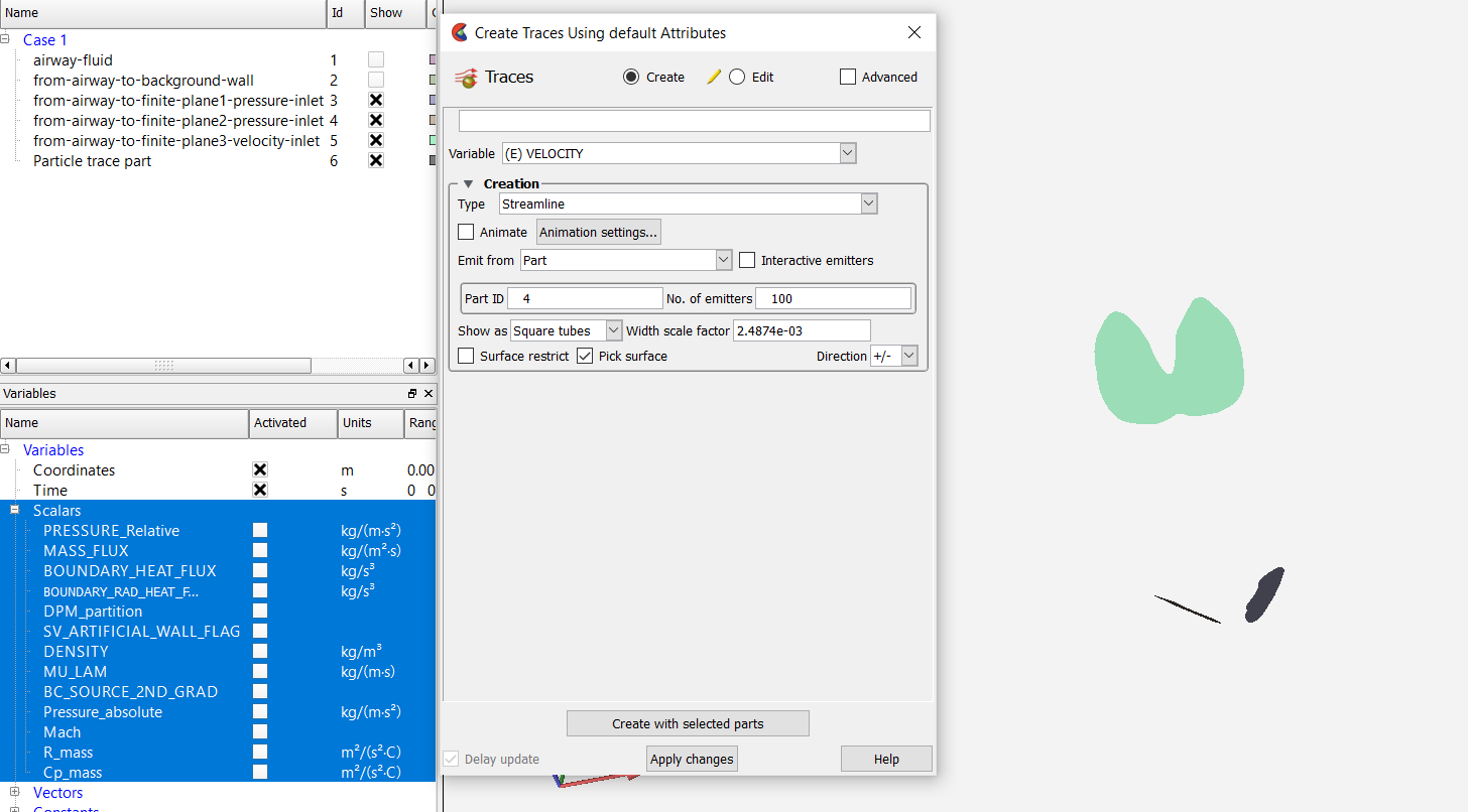

SubscriberYesterday I was using ensight to analyse date at a single transient timestep, and I was able to generate a particle trace velocity streamline from the inlet of the flow, I then closed the software and reopened it to generate the same particle trace, but the it doesn't show again, can someone tell me why this occurs, however if I select the fluid it creates a streamline but is disconnected and not as this picture, I just don't understand why it was working but suddenly stopped

Not sure I understand your question right, can you please elaborate on the steps that you performed before and after reopening EnSight? It seems to me that you are performing 2 different operations at the 2 the instances. In that case, you are bound to get different pathlines.
July 9, 2021 at 1:54 pmJuly 11, 2021 at 2:28 pmRahul Kumar
Ansys EmployeeSelect the fluid domain from which pathlines will be evaluated and then plot streamlines
