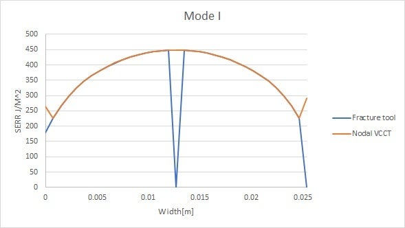

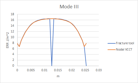

      The ANSYS fracture tool distribution of energy release rate is different when I obtain the energy release rate from nodal value directly. They are totally different at one side; moreover, there is a small difference between the values of Fracture tool and my calculation.
      I have attached here both the values and graph.
      Direct VCCT is the result of Fracture tool. In nodal VCCT, I export nodal force and displacement directly and calculate VCCT using the same formula that ANSYS uses.

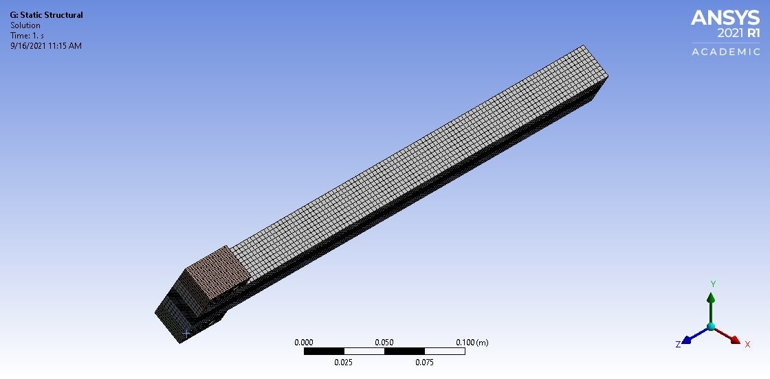

      I modeled DCB under mix mode I & III loading condition. I attached the geometry here.

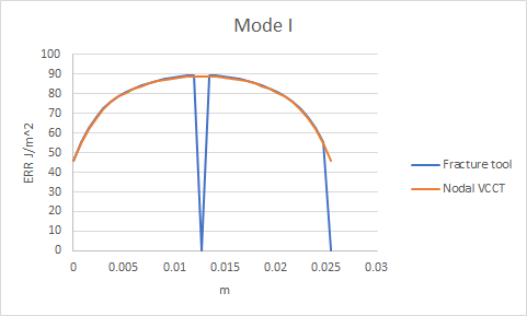

      I have attached here the distribution of mode I and mode III energy release rate. The fracture tool cannot obtain energy release rate at the edges and center of the specimen for both mode I & III when I use a refined mesh. However, the nodal vcct works perfect. (Nodal VCCT: First, extract the nodal force and displacement and calculate the energy release rate myself)
      In my opinion, this is a postprocess error, because I have to arrange(sort) the data to calculate the energy release rate myself.

      I have attached here a simplified model(the .dat file).
      Again, I calculate ERR by formula and plot it against the fracture tool for mode I and mode III.
      Thank you for your time.

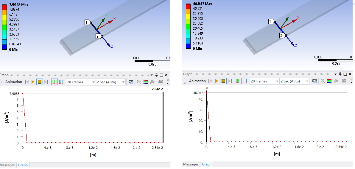

      Another problem that I have with the fracture tool comes from the local coordinate system of the crack tip.
      I explain it here.
      For example, the first picture shows the ERR for mode I and III for the defined coordinate system. However, clearly, this is not correct. (in both images, the right is the mode I, and the left is mode III)
      By rotating the coordinate system, the value becomes acceptable somehow. (the edge and center values are not satisfactory)
      By definition, both of them must work; nevertheless, the fracture tool cannot calculate the ERR in the first case.
      Indeed, the crack-normal and the crack-tangent are well defined by each method.

      the local crack cs appears to be flush with the crack front. Can you move it slightly, so that it is still on the open side of the crack, but not flush with the crack front?
    • Ali_sh
      I appreciate your help.
      I checked what you mentioned, and it solved the problem.
      I attached the result here.
    • David Weed
      this looks good. This is stated in the help, but it's a bit obscure: https://ansyshelp.ansys.com/account/secured?returnurl=/Views/Secured/corp/v221/en/wb_sim/ds_crack_overview.html
      For thePre-Meshed CrackandArbitrary Crackobjects, the origin of the coordinate system must be located on the open side of the crack.
