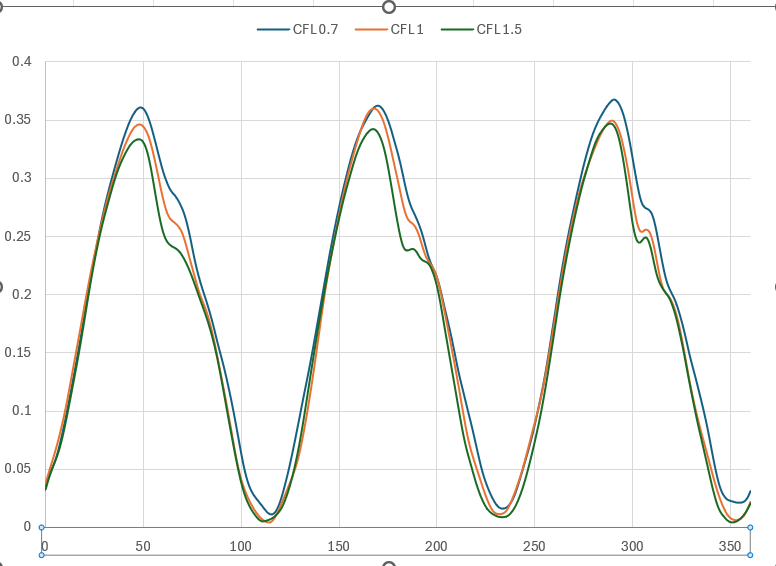

      Hello Everyone,
      I am a master's degree student working on my thesis. I am running a 3D transient simulation with coupled solver and IDDES turbulence model. The problem is that I am struggling in choosing the approriate CFL number found in Solution Controls. It's 200 by default, but it gives wrong power coefficient. I tried numbers like 1, 0.7, 0.5 and I realised the following: the more I decrease the CFL number, the larger the power coefficient gets. So I am confused on what to choose as my CFL, because for each Tip Speed Ratio it's different. i tried tunning it for each TSR, but I feel I am doing it wrong because I am trying to validate the setup vs. experimental data and I should not change settings for each TSR.

      What is the equation of power coefficients you are using? Are you sure that CFL number is the only one which is impacting the results? There can be other factors which may be affecting the results.

      I am using the moment coefficient defined in report definitions. I am averaging it over a complete turbine rotation, and then multiplying it by TSR to get power coefficient (Cp=Cm* TSR). So basically CFL in solution controls is affecting the moment coefficient, which in turn affects the power coefficient.
      And yes after trying several simulations while changing CFL number only, the moment coefficient was changing such that: increasing CFL makes Cm-avg smaller, while decreasing it makes it larger!

    • mohalinasre2001
      I made this graph to show you how increasing CFL slightly moves the moment coefficient curve downwards, which in result leads to decrease the average moment coefficient. Each curve is taken from a seperate identical simulation with different CFL as shown. They are all taken at the same time (5th revolution of the VAWT).

      I did a timestep sensitivity study, I tried azimuthal increments of 0.6 deg and 1.2 deg for turbine revolutions, and they gave the same moment coefficient curve. I even tried lower timesteps (0.1 and 0.25 deg) but I got a totally wrong solution. So I don't think lower timesteps will help.
      Based on the paper I am referencing in my thesis (Experimental and numerical investigation of a three-dimensional
       vertical-axis wind turbine with variable-pitch), they used 1.2 deg increments, and it worked fine with LES turbulence model.
