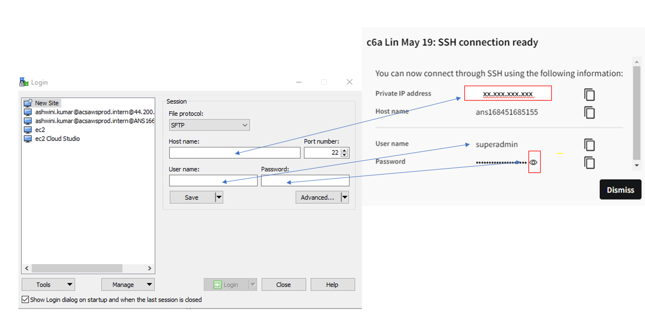

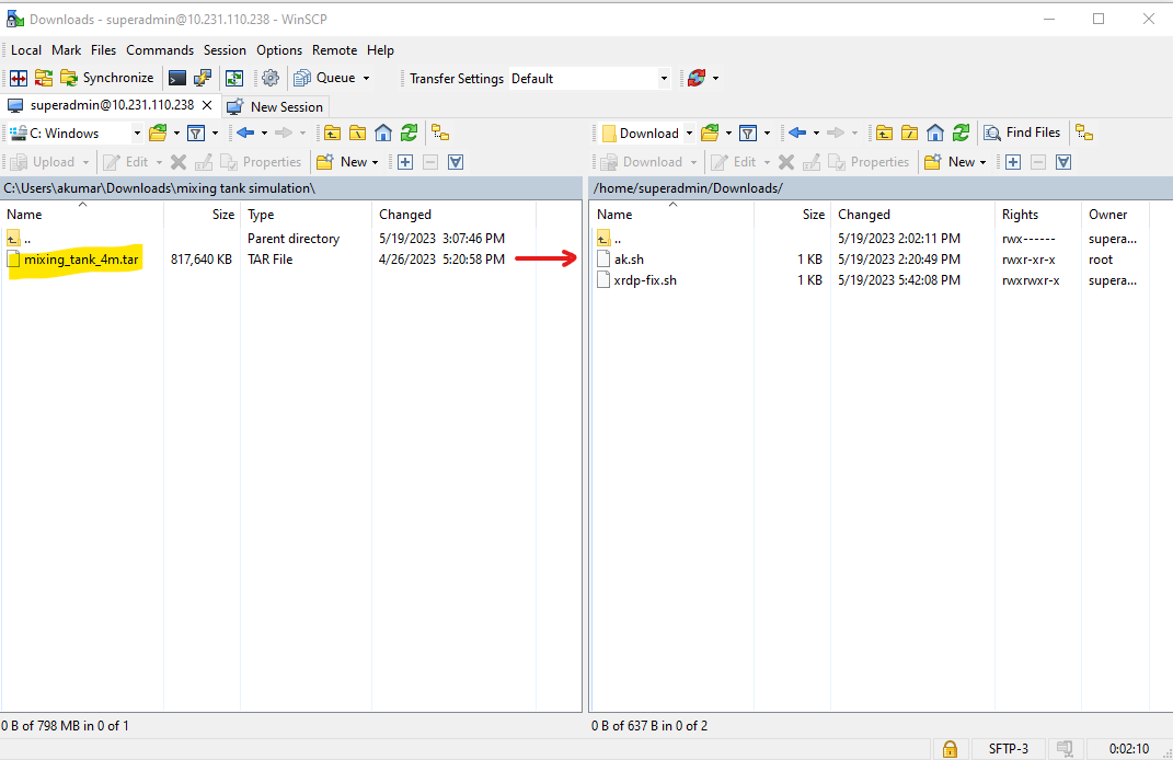

Using winscp to transfer files to Ansys Gateway powered by AWS Virtual Machines
    • Ashwini Kumar
      Requirements:
      • Approval from your IT to use winscp
      • Private IP address and superadmin password of the VM where you want to transfer files to [see /forum/forums/topic/how-to-ssh-to-linux-vms/]
      • VPN if your VPC is behind firewall
      Steps:
