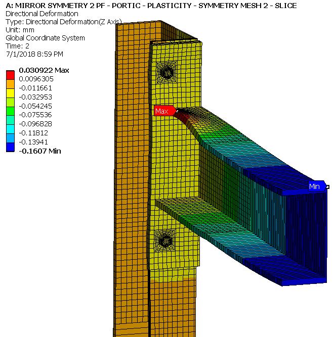

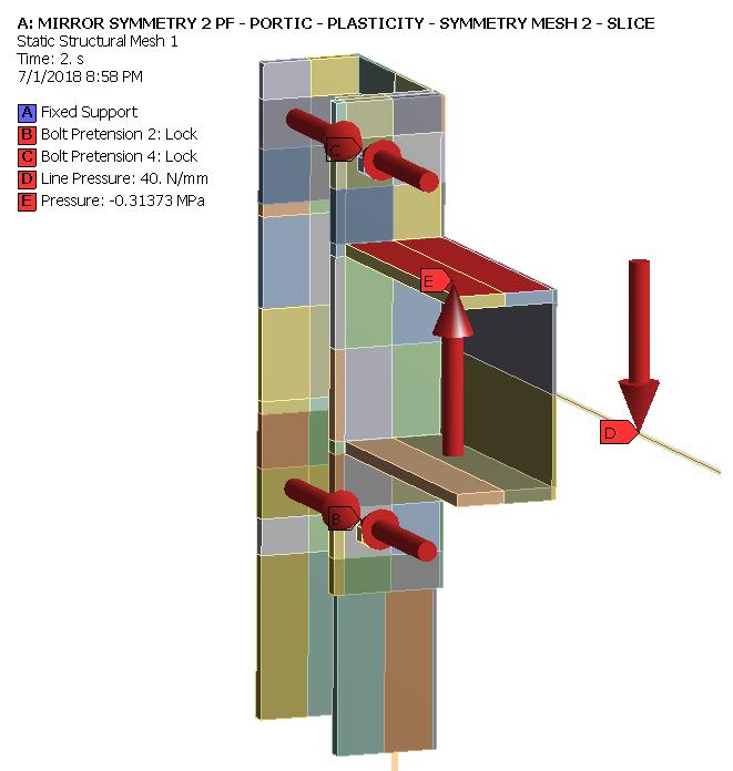

July 1, 2018 at 11:40 am
Fabricio.Urquhart
SubscriberNow I am trying to model with two planes of symmetry, the firs is in the center of I beams, and the other is perpendicular to the beam, in the middle of the portic. The results are not OK, it does not seem to be the plane of symmetry.
I would like to model the half portic with a plane of symmetry in the middle. Because if I model the full portic, the other side impact in the results of my connection. So I am trying to use the plane of symmetry, to have the same connection in both sides of the portic.
The model with the plane of symmetry is attached.
July 2, 2018 at 12:59 am
peteroznewman
SubscriberFabrico, I made some changes to your model with the Symmetry. You didn't have the beams selected for having a plane of symmetry. I added that. I also changed the axis of symmetry you had selected.
I left the pressure on the solid pointing up, but I expect that may be a mistake in your model. Positive pressure is always into the face.
If I change the sign on the pressure, it still converges.
Attached is my version of your model in 18.2 archive.

SubscriberFabricio, that face was missing in the model you uploaded. I did not look at that joint. I have now added that face to my model and am running it now.
July 3, 2018 at 12:24 am
Fabricio.Urquhart
SubscriberPeter, when I compared the two portics, first with symmetry in the solid and half crosse section, and the second without symmetry and full cross section. I did not use symmetry in the beams. I selected only the face of the solids, and use a joint between beams and solids. And it was the same results.
Is it correct to use symmetry with beams?
July 3, 2018 at 12:47 am
peteroznewman
SubscriberFabricio, in my model above, I added symmetry to the beams. I have now added the missing face in the joint and it converged in the same 54 iterations as before.
Yes, you need symmetry on the beams as well as the faces of the solids.

July 3, 2018 at 5:03 pm
peteroznewman
SubscriberFabricio, I made one change to that attached model, I changed the sign on the Pressure, since you want the load to be downward, which is a positive pressure on the top faces. I cleared the mesh, remeshed and solved.
It converged in 78 iterations.
I recommend you change step 1 initial substeps to be 10 instead of 5 to eliminate all those wasted iterations in step 1 that resulted in a bisection.
July 7, 2018 at 4:29 pm
Fabricio.Urquhart
SubscriberHello Peter, this model converged. But, now I am changing the parameters and some models did not converge. So I have read this article Convergence, and used lower normal stiffness factor (0,2) and the detection method "Nodal-Normal To Target" in place of "on gauss point". But the model did not converge yet.
So I change the initial and minimum substeps to 100 and maximum substep to 500 and the model did not converge.
I think that the problem is in the joint between cross section and solids, as you see the residual in the picutre below:
The model is: "PF22mm - CH19mm - DP450mm"
July 8, 2018 at 12:38 am
peteroznewman
SubscriberDear Fabricio,
The convergence problem does seem to be at the joint between the solid elements and the beam elements on the portico.
I counted 3553 nodes in the solid part of the portico (excluding flat plate), which is 353 mm long, so about 10 nodes/mm.
There are 35 beam elements over a distance of 519 mm in the remaining part of the portico.
By adding about 5190 nodes to a model that has 56,340 or about 9% more nodes, you can get rid of your trouble spot.Â
You can cut that in half if you double the element edge length along this section.
I recommend you resolve the convergence problem by replacing the beam elements with solid elements.
