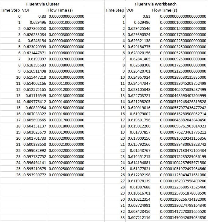

I have used the GUI to setup .cas and .dat files that I am running on a cluster. For my simulation, I would like to use error based adaptive timestepping, however I cannot get this to work through the cluster. My .cas file contains the correct timestepping parameters in the GUI.Â
Are there any text commands I should be using to apply error based adaptive timestepping?Â
P.S I have tried some commands which work in the Fluent console but do not work when inserted into my script file.Â

SubscriberHi - so these are my parameters; initial time step 1e-07s, maximum time step 1e-05s and minimum time step 5e-09s.Â
When I run on the cluster, my initial time step is 1e-06s and remains this. When I run the same case through Workbench, my timestep begins at 1e-07s and then is adaptive.Â
I have briefly run the same case on both platforms to compare below:

Rob
Forum ModeratorIf you open the case up on the cluster what settings can you see? I'm wondering if the set up wasn't passed over, but I've not seen that happen before.Â

SubscriberHi, sorry for the delayed response. I am new to using cluster and only know how to run my jobs in batch mode... I have removed the '-g' command from my fluent load line but I now get a display error that I will have to figure out.Â
My supervisor and I have discussed and she thinks it is potentially related to the 'solve dual-time-iterate' text command in my script file. If I remove this my simulation doesn't run. Could this be the case? ThankyouÂ

Rob
Forum ModeratorYes, that may be overwriting the adaptive time stepping. Test it on the Windows machine to see what it does, you may need a slightly different command.Â
-g does something with the GUI for batch runs, if the cluster doesn't have graphics (or can't push them to the machine you're sat at) you may see an error.Â
