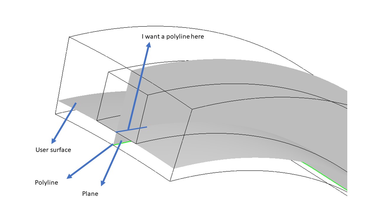

 How to create a poly line on user surface?In the boundary intersection list options,the created user interface is not available. I wanted to create a poly line on a curved surface for that i was trying the option of intersecting user surface with a plane.

SubscriberCan you attach a picture of your geometry? A simple pictoral schematic of what you're trying to do would help us provide a possible solution.

ashiadarsh
SubscriberCan we offset an existing polyline in CFD post?

SubscriberThere was a discussion related to getting a polyline in CFD-Post. Please see the discussion here. If you can attach your workbench archive file here (.wbpz), I could take a look at it.
