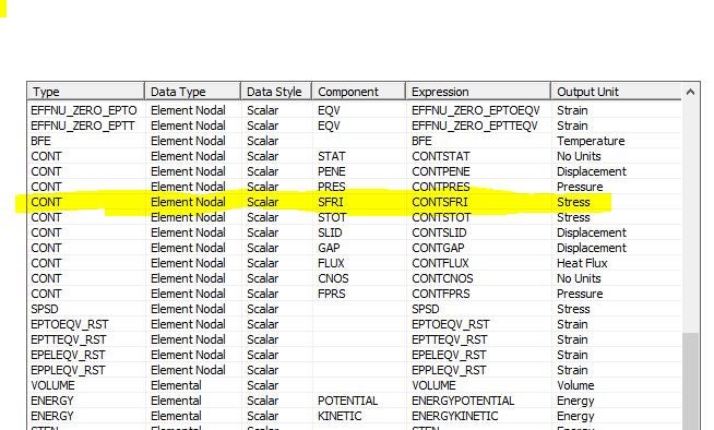

Thank you for the link, that's very helpful.In terms of CONTSFRI, i've attached a screenshot of the option available in the worksheet:
Based on the link you sent me, I assume for my application using contsfri (frictional stress) is the best option since I want to look at the shear along a surface, then compare those shear stresses and pressure when applying different boundary conditions/ materials. Is my understanding correct?

The expression CONTSFRI is for contact friction stress. Please see if the following link helps you: Maximum Shear Stress Result In ANSYS® Structural Analyses (mechanicalland.com)
