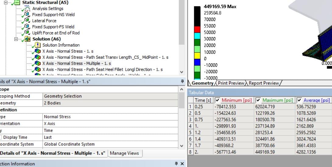

      i noticed when i change the number of steps from 1 to 2, the time or step number  in solution result name doesn't change from  1 to 2 as shown below.
      Is there a way to make it update the defined name to reflect the step number?

      This is static nonlinear analysis.
      Please take a look at analysis below. The results are based on step=2 or time=2.

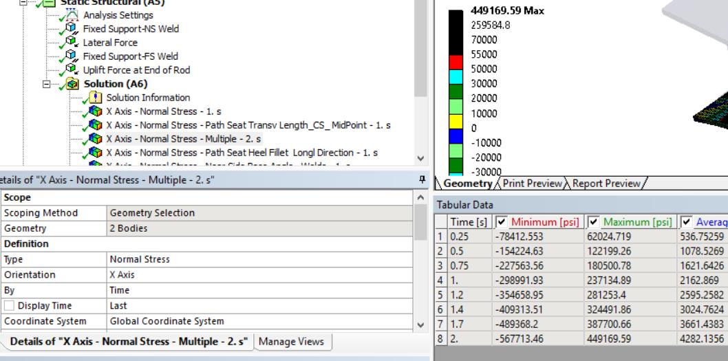

      When i Rename a specific solution Based on Definition then result changes to -2.s as shown in 2nd screen shot. So it doesn't update itself. Thanks!

      That is not a parameter and looks like a text object. So, you would have to manually change it.
      The main thing here is that the results are correctly displayed according to what Display Time shows i.e., Last step.
