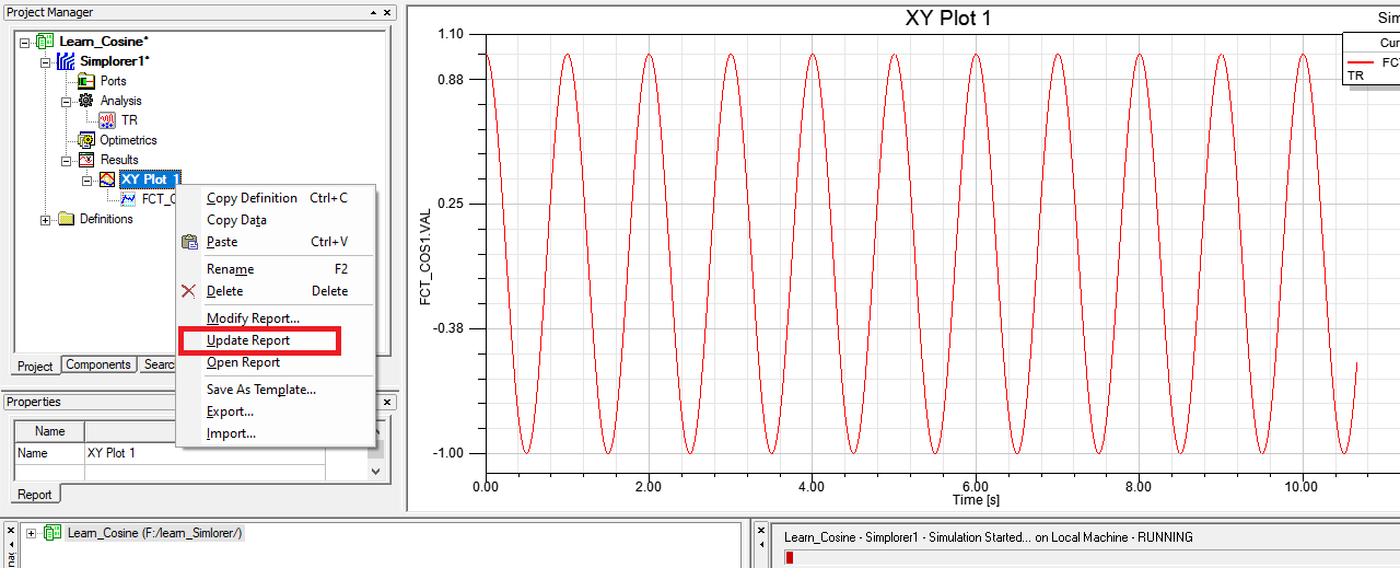

I am simulating a basic cosine block in Simplorer.
Every-time I wish to monitor how far the simulation has reached, I need to hit the 'Update Report' button.
May 4, 2021 at 8:12 pmJose Luis Gonzalez Hernandez
Ansys EmployeeHello To see the reports update live with your simulation, you need to add a probe in your schematic. Select a wire or block and right click , select "Probe", and select the variable you want to track. This will create a plot directly on the schematic, you can also access it from the Project Manager.
Best Jose-Luis
