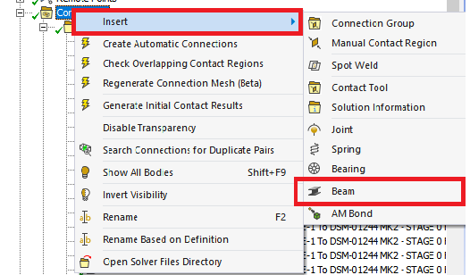

I have a model that includes a large number of beam connections.
I am running a parametric study with the current model, and whenever the geometry changes the beam connections are not updated.
Is there any way of updating the connections automatically and not manually ?

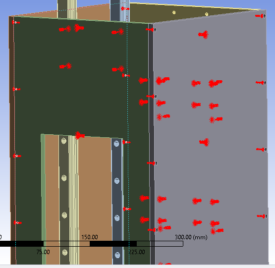

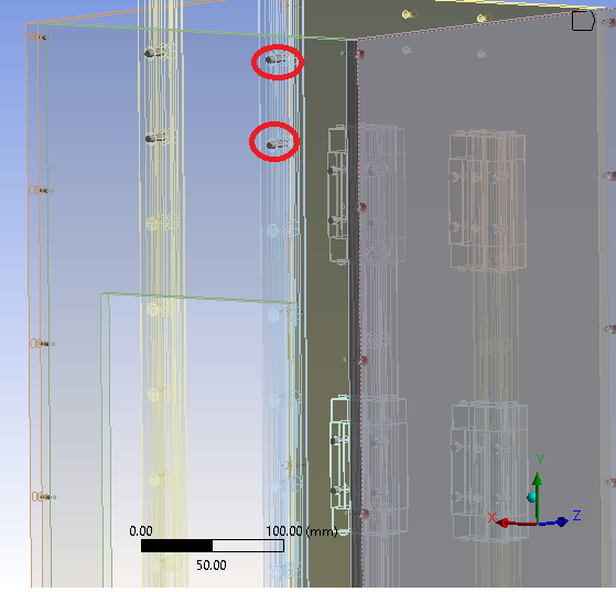

I have uploaded, below some pictures of the model.
In the model I have more than 100 bolts, to support the plates, modeled as beam connections.
I want to run a parametric study, changing the thickness of the plates.
But while the geometry of the model changes, the "beam connections" they dont get updated, even if the mobile and reference geometries are scoped to named selections.
I was wondering if there is a way to update these connections, during a parametric study like this.

SubscriberWhen a Beam Connection is created, the Coordinate System is Global.
That creates a problem when the length of the part changes, the beam is left behind.
You have to make a Coordinate System scoped to the geometry that is moving, then use that Coordinate System in the Beam definition.
Now the beam will follow the length change.
ANSYS 2021 R2 archive attached.
February 14, 2022 at 9:32 amVasilEvangelos
SubscriberThank you both and for your help.
I tried the method that you suggested and it's working.
This method is really helpfull because in bolts modelling tutorials, is stated that one major drawback of the "beam connections" is that you need to re-generate them from scratch if the geometry changes.
This step can save you a lot of time.
