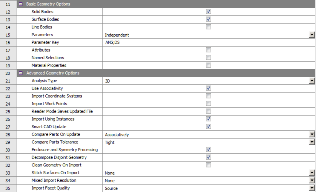

      It has happened to me many times that I have a fully defined model (materials, mesh, contacts, etc.) and I need to make a change to a part of the geometry. I go to SpaceClaim, make the modification, and return to Workbench. I double-click on the model and click "Yes" when asked if I want to update the model. Sometimes it does it correctly, but other times it interprets that I have modified or added a lot of parts instead of the single part I changed. It messes up the parts I had previously grouped in folders in the geometry section, loses the contacts (I have disabled automatic generation), and even loses the mesh.
      Why does this happen? Is there any way to fix it?

      Hi
      In workbench, right click on geometry cell and click on properties. In the properties pane, there is an option called 'Compare Parts on Update' under Advanced Geometry Options. By default it is set to NO, change that to 'associatively'. The option compares the existing geometry and updated-to geometry to determine if any bodies/parts remain unmodified. When you choose the Refresh Geometry context menu option (right-click the Geometry tree object or anywhere in the Geometry window), if no changes to the body are detected (found to be unmodified), then the body/part does not need to be remeshed after the update has occurred.
      Also, make sure that Smart CAD Update is also checked.
      Refer to this article in Ansys help: Compare Parts on Update (ansys.com)

      Thanks for the two comments.
      Switching to "Associative" in the advanced options of Geometry seems to work quite well.

    • ABHIJEET.CHILWIRWAR
      Hi Team, I am facing the same issue and I have gone through this thread. I've already implemented the above solution provided but for me the problem still persists. Please help me overcome the current challenge.
      Note: Till now everything, everthing was fine but suddenly this issue appeared without me tweaking any options in ansys.
      Here's my geometry properties:
