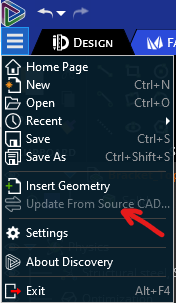

      Hi, how is this "Update From Source CAD..." in Discovery 2020 R2 works? Is it require CAD software to be install? Does it require license for Geometry interface? Does it support Solidworks? Best regards,

      This option does not seem to be working for me as well. Let me check with my team and get back to you.
    • Ethan Thompson
      Hello Sapha
      Yes, this requires an active CAD installation that matches the file type that you input.  Once this option is selected, you can replace your CAD file and Discovery will do its best to remap your boundary conditions

    • jp_miller
      Hi Subashni Ethan Thompson
      I have the same issue.  I can import an Autodesk Inventor file, but the Update from Source CAD is greyed-out.  Do I need an Autodesk add-in to get this t work?
