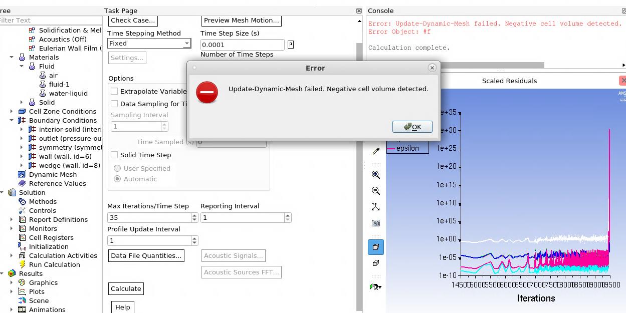

SubscriberThere are many factors to consider:
1. Type of mesh (try using tetrahedral)
2. Time step, start with a relatively small time step
3. Mesh resolution, make sure to have a better mesh resolution
Depending on the type of problem you are trying to solve you need to use the correct setup for dynamic meshing.
