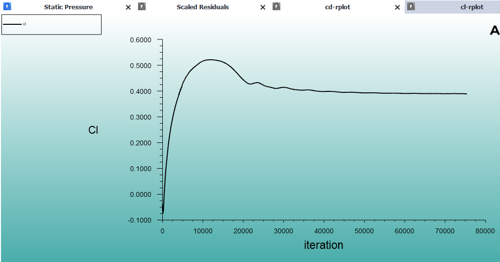

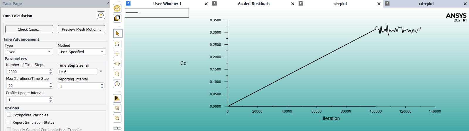

      I am simulating a single compressor blade in fluent 2021 R1. I have obtained a converged solution (attached cL results) and now i am proceeding with LES simulations. I have followed the procedure to simulate LES based simulation, as suggested in ansys user guide and i am using  bounded central differencing scheme for both transient scheme (according to the ansys user manual suggestions) and all the flow variables as well but according to the attached cD result attachment, simulation become really unsteady.

      LES will be inherently unsteady, and will oscillate slightly around a given value. If you look at Cl from iteration 100k (I assume this is when you started LES), you should see something similar.
      You can sample this data and compute the RMS value of Cd to get a time-averaged value.

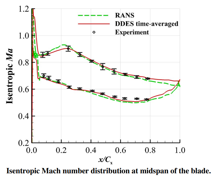

        Yes you are correct i have started this simulation at 100k  th iteration. In this simulation i have validate this against a exp data (isentropic mach number VS chord, attached picture) so honestly i am using cD and cL values to check the convergence. I need to have a reasonable steady condtition in LES to get the data to validate against experiment data.
        Isentropic mach number VS chord

      You say that you have a converged solution–this is likely for a steady RANS solve. Remember the A in RANS stands for averaged. This averaging is done in time to make the problem easier to solve. The downside it, it removes the fluctuations in the flow field and only gives us a time-averaged value. For many problems this is sufficient to provide an engineering representation of the flow field.
      An LES on the other hand is a transient simulation that will allow these fluctuations in the flow field to develop. This is could be why you are seeing the unsteadiness in these coefficients. (It could also be diverging. Are the residuals behaving well?) If you were to save all the flow fields from your LES and then average them, it would (to some reasonable approximation) match the steady RANS simulation from above.

        LES simulation ran without diverging and i have set up the simulation for 2000 timesteps with 60 max iteration per time step and delta T is 1e-06. i have attached a pictures of residuals and cL results with LES settings as well.
        For my case, flow through time is 0.001148s but in the simultion happened only for 0.002s but the results are not suitable for the validation. So does it mean i have to run at least 1s or there is something wrong with my case set up ?

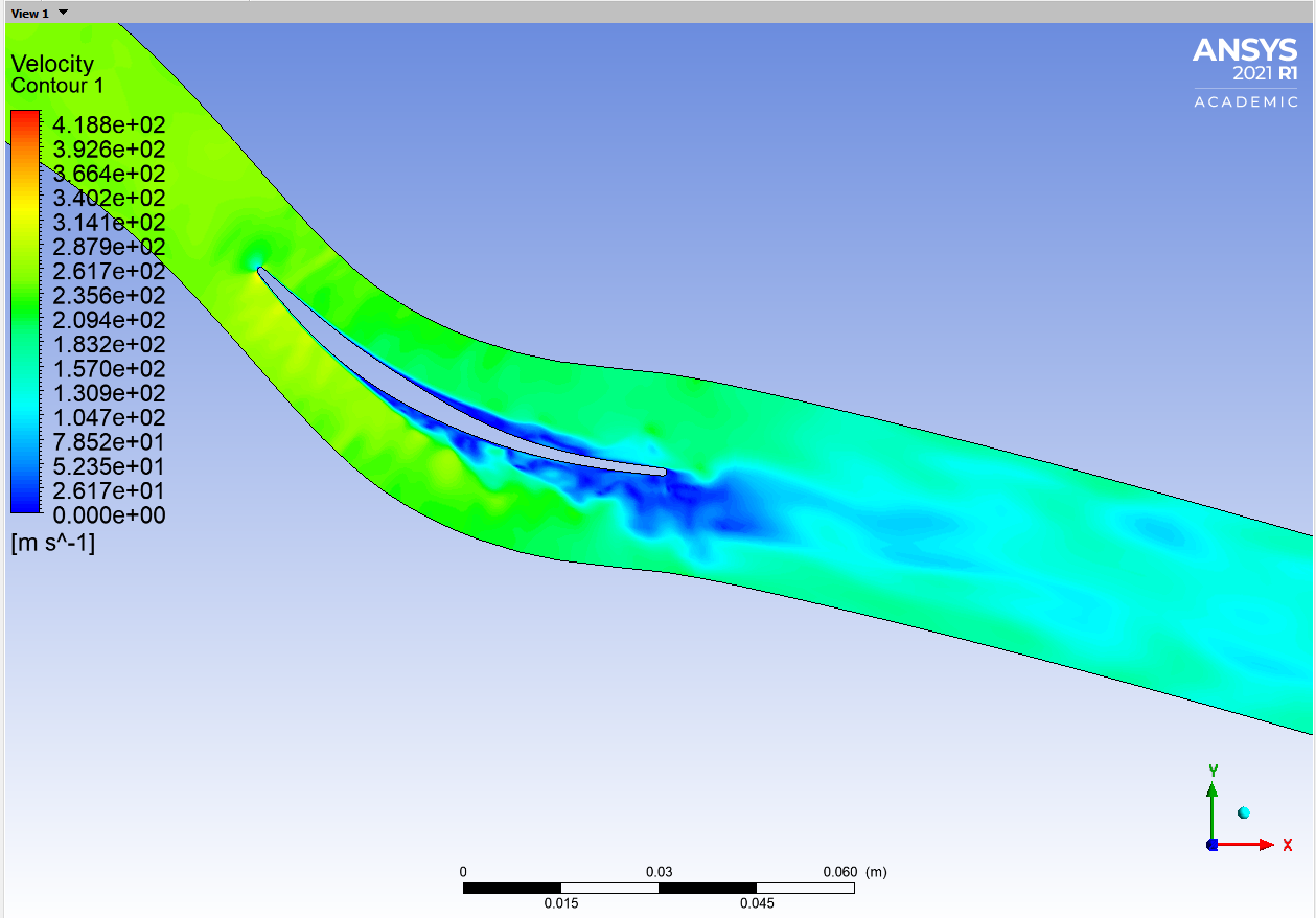

          So basically what you have mentioned in the 1st paragraph is, that 0.002 flow time in the LES simulation is to lower the influence of my initial condition values and make the simulation environment settle for LES (correct me if i am wrong). Just had a thought of running more of flow through time till 1s, since flow has not developed (attached velocity contour).

          What is the goal of the simulation? Are you interested on this blade or the downstream one? If it is this one, you might be able to start collecting data. Waiting until 1 second seems like a bit too long. I don't think you want to wait 10 years for your solution. If it is a downstream part you are interested in, then maybe a bit longer. A good way to visualize the shed eddies is the vorticity. Look and see if these are dissipating at roughly the same spot. This can be an indication of start-up effects being removed from the simulation. Better would be to use a couple of monitor points on surfaces or at points you are interested in.
          If you can reduced your iterations from 60 to 45 you would be saving 25% of your wall clock time, and a reduction to 30 would save you 50%. If you want a more accurate solution, it would probably be better to increase the number of cells and have less iterations. If you look at the quantities of interest from iteration 45 -> 30 -> 15, I would imagine there is little change.

          Aim of this simulation is to validate the blade profile using advanced turbulence modal(attached picture), either DDES or LES. Yes, you’re absolutely correct about the timing and with my current resources, it will take many weeks to reach 1 second. The reason i have mentioned about simulating the case up to 1 second is that because in most of the research papers that related to turbomachinery, they have carried on the simulation between 1s and 5s for accuracy purposes. To assign monitor points on the surface, can i set up that in fluent before starting the simulation or do i have to do it in CFD-Post ?
