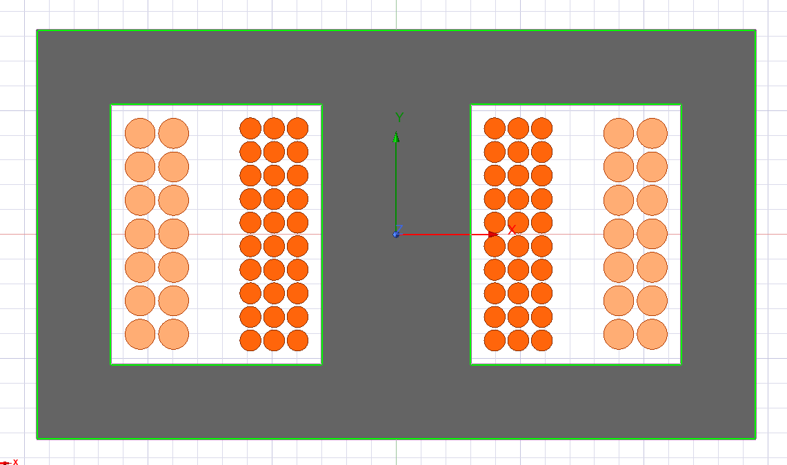

      I'm simulating a 100 kHz transformer for a Dual Active Bridge (DAB) converter and I'm running into unrealistic winding losses.
      In the first few timesteps, the solid loss spikes to around 50 MW, then settles down to a peak value of about 6 kW. Even this value seems far too high for a 25 kW transformer design.
      Here are the settings:
      The transformer windings are supplied external by two rectangular voltage sources with rise and fall times of 1e-7 s. Primary Side Resistance 5.27e-3 Ohm and secondary side resistance 11.16 Ohm in the external circuit which should model the end winding.
      2D Magnetic Transient Simulation XY
      Boundary Condition: VectorPotential: 0
      Excitation:
      30 coils on primary side were assigned for primary winding and 14 coils on secondary side were assigned for secondary winding.
      Number of parallel branches: 1
      IsSolid: Solid
      Set Eddy Effects: On for every turn
      Set Core Loss: On for only core
      Mesh: 6400 elements (air 2277, core: 991, turns_pri: 32, turns_sec: 40)
      Solver:
      Output per object core loss: yes
      Output per object solid loss: yes
      Time Decomposition Method Option: Periodic and Half-periodic
      Materials:
      copper_pri: Composition: Litz Wire (Strand number: 223, Wire Dia: 0.1mm)
      copper_sec: Composition: Litz Wire (Strand number: 450, Wire Dia: 0.1mm)
      Ferrite Core: Core Loss: B - P Curve
      Values:
      U_in = 800V
      U_out = 350V
      n1 = 30
      n2 = 15
      u = n1/n2
      r = u*U_out/U_in
      phi = pi/3rad
      f_sw = 100kHz
      stopTime = 0.5*1/f_sw
      stepTime = 0.005*1/f_sw
      Model depth: 50 mm
      Thanks in advance for any input.

      The initial spike is just a transient behavior and it can be ignored. Please check if your current value is expected.
      GL
