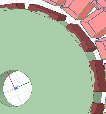

SubscriberI did draw an arm for my generator design by 3d rectangle in Maxwell 3d. I am adding the arm with stator together by using unite.
When I am trying to validate my design, its saying an error showing that the two block intersect. I was wondering what I am doing wrong?

SubscriberWhen blocks with different materials, or boundary conditions, or other properties intersect, HFSS/Maxwell geometry engine, which is not based on object priorities (which would limit flexibility in high complex projects) can not decide which material or property to apply to the intersecting area. The only case where it CAN decide is when a smaller object is completely submerged in larger exterior object, like the airbox.
So you have to use boolean operations for defining the objects and parts explicitly.

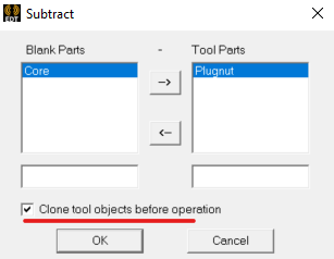

Forum ModeratorHi @umozumder Use subtract command, select clone tool objects before operation on the popup window, and then use unite command.

Forum ModeratorHI @umozumder May I know why do you want to unite them in the first place?
If the magnets you modeled are not sitting on the rotor curvature and interfering with the rotor - Just subtract the magnets from the rotor and check "clone tool objects before operation on the popup window"
If the magnets need to be placed in a cutout on the rotor - first create the cutout using the boolean operations as suggested byand then place the magnets.

SubscriberHi Navya
Thanks a bunch. That worked. My simulation is running.
