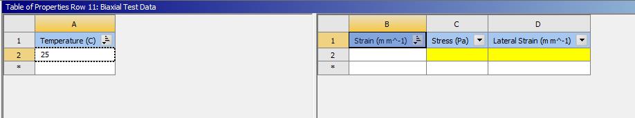

I am trying to input my own biaxial test data (stress and strain) into EngineeringData, but I found that the unit for strain in the interface is mm^-1. Shouldn't the unit for strain is mm/mm or in/in....?
Another question is, is there anyway to perform curve fitting for some anisotropic materials? I saw the material models that are supported in ANSYS to do curve fitting are mostly isotropic hyperelastic.Â

Ansys EmployeeYou are correct and if you look closely there is a space between m and m^-1 ....so this m/m....if you change the units to mm...it would look mm mm^-1 or in other words mm/mm
Also, we don't support curve fitting anisotropic materials, it's a elaborate process and has to be done outside ANSYS
