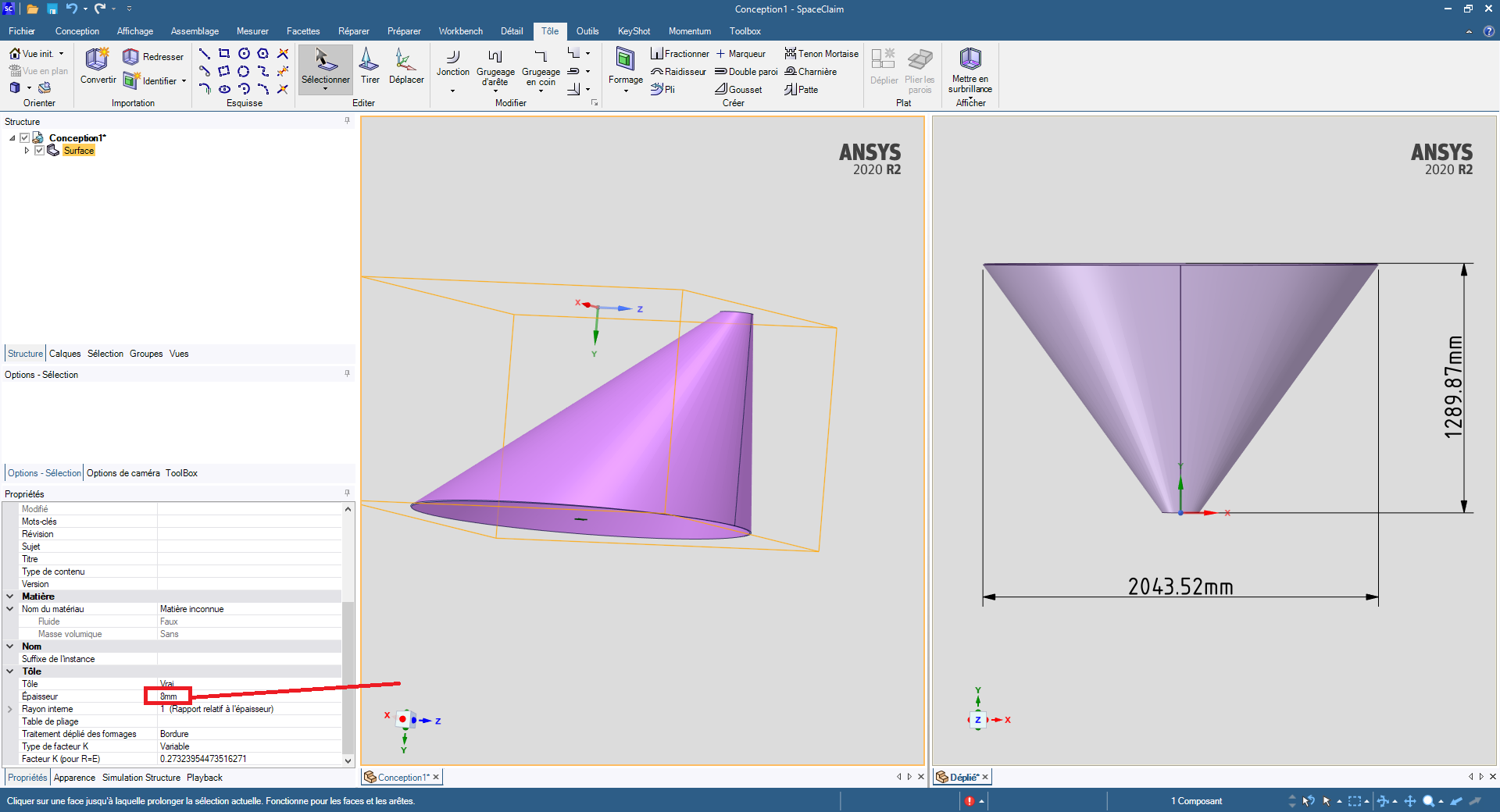

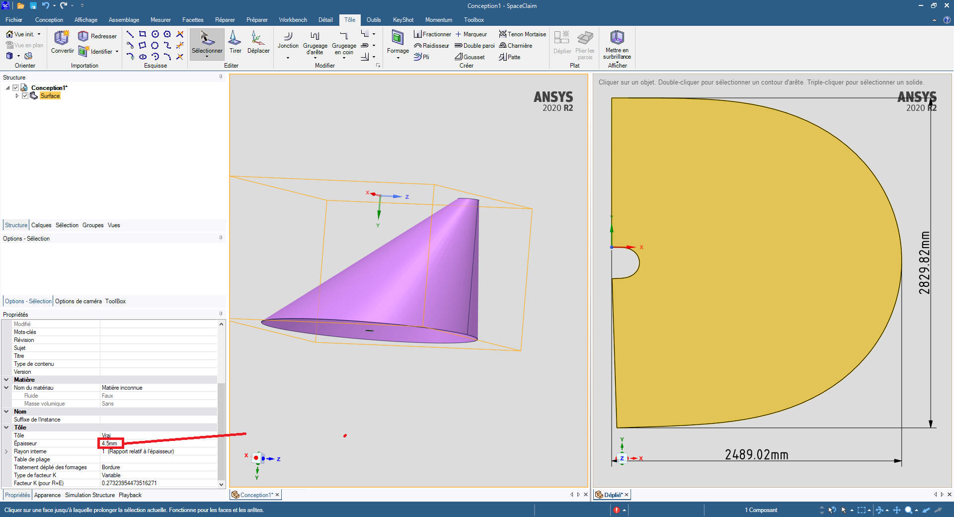

SubscriberHello, I'm encountering a problem on an unfolded sheet metal: this piece can be unfolded up to a thickness of 4.5mm, at 8mm it doesn't unfold anymore...(see photo). Do you have an idea or an explanation? Regards

Ansys EmployeeHi charlie
Let me look into it and get back to you.
January 7, 2021 at 3:15 pm
Naresh Patre
Ansys EmployeeHello charlie
This appears to be a bug and I will report it to the development team.
January 7, 2021 at 3:23 pm
Charlie
Subscriberthank you
January 13, 2021 at 7:19 am
Naresh Patre
FYI, I have submitted BUG 392639 for this unfolding issue.
April 21, 2021 at 12:31 pm
Naresh Patre
This unfolding issue submitted through BUG 392639 has been fixed in next version to be released i.e. 2021 R2.
April 21, 2021 at 12:38 pm
Charlie
SubscriberNaresh PatreÂ
Glad to hear it! Thank you very much
