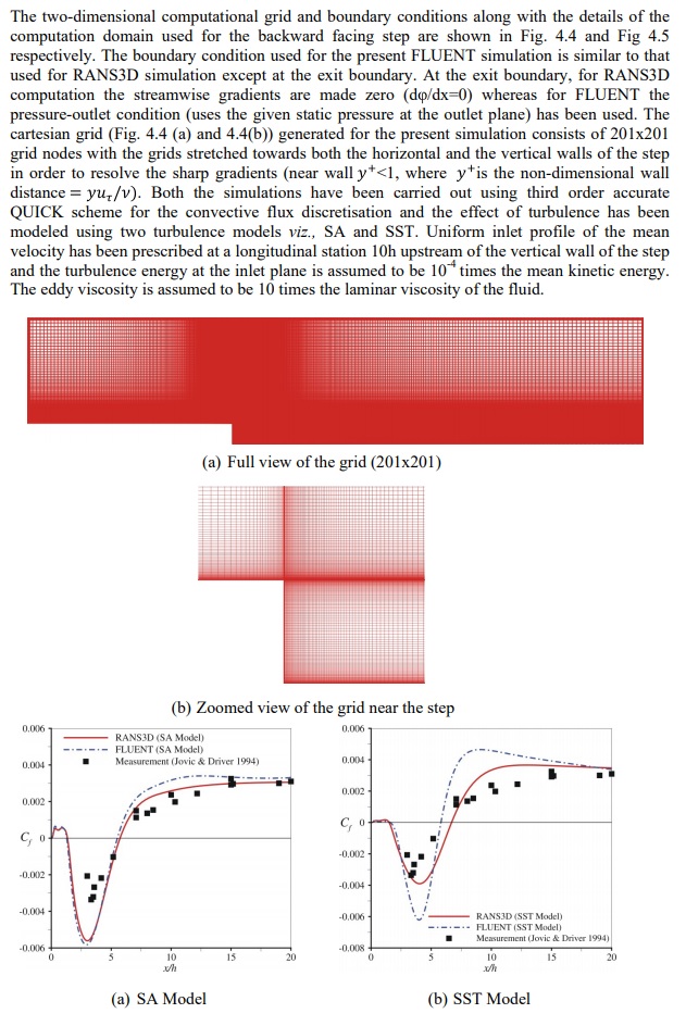

SubscriberHello everyone. Well, the publication aims to resolve doubts about the results obtained by FLUENT when compared to experimental results, I share with everyone for general understanding.
The flow in question is the flow through the divergent channel, backward facing step geometry. The simulation is based on the experimental study of Jovic and Driver (1994), an experimental study carried out to serve as a basis for numerical analysis. From this, we have the computational domain schematized in the image below. (Geometry values in h function)
The Reynolds number is based in step height h= 0,98 cm, U velocity = 7,72 m/s and std air 20° C conditions is adopted like in JD experimental study. At inlet velocity magnitude is prescribed normal at boundary with U= 7,72 m/s and viscosity ratio of 10 (for k-epsilon and k-omega I set the turbulence intensity to 5%). At wall no slip condition and adiabatic surface is imposed and at symmetry I set as symmetry line.Â
A quadrilateral structured mesh is generated with y+Â < 1 in adjacent wall cells. We can see in the image below a zoomed view of mesh.Â
So,Then I will demonstrate the graphs of Cf vs x / h and Cp vs x / h displaying experimental and numerical results from the Sparlat-Allmaras model.
As expected we can see a double change of sine on the chart Cf vs x / h which indicates the presence of a recirculation zone composed of two bubbles, one smaller at the base of the step and one larger a little forward. This is shown by the image below with the colored vectors for velocity, results for model S-A.
The Xr indicates the reattach length and for this case we get a Xr/h value equal Xr/h = 6.5. According with the experimental data from JD the mean value of rettach length is Xr/h = 6+- 0.15. An acceptable difference of 8.33%.Â
It is visible that, by plotting Cf vs x / h, the result obtained by FLUENT overpredicts the coefficient of friction experimental curve and has values closer after the reconnection zone.
But what intrigues me is because the graph of the pressure coefficient is so below the experimental one that the graph Cf vs x / h has an acceptable agreement between the curves? Is it because of this approach being 2D and the real approach being 3D? Together with the experimental material, it contains results for a 3D simulation by DNS that the values coincide for both the pressure coefficient and the skin friction coefficient. I tested severe differences between models (I only showed the result S-A because they all exhibited similar behavior), I changed pressure-velocity coupling, etc. but they all exhibited satisfactory agreement for Cf, but for Cp no? What could be behind it? This is the big question ...

SubscriberHello guys, So I tried to get a converged Cp chart with the experimental. I measured the wall static pressure at x/h= -5.1 and input in the expression according with the image below.
Now the Cp chart is better than before, but is still above the experimental, I will see if I improve the mesh (imposing a higher density near the step with a horizontal edge sizing and not just vertical towards the wall). But it is already better than before, for the k-epsilon and k-omega models I adopted turbulence intensity equal to 1%, according to the JD experiment the measurements indicated below 1% but it is not written exactly as it was.
Below have the vectors ploting velocity, we can see the difference of recirculation region through different turbulence models. For the S-A the reattach lenght is about 6.5h, for Real k-e and SST k-omega about 6.8h, according with JD experiment the reattach length is 6 +-0.15 h.Â

Hello, so Kremella you say to me try to create a tighter mesh in horizontal direction and I found a pdf archieve of some validation cases in internet using FLUENT. In image below have the section about the BFS simulation with comments over mesh, numerical procedure and Cf graph results and in this case the autor used a tighter mesh in horizontal direction and the results is very similar with my results... Look. He also used 10h of inlet duct length and uniform velocity profile at inlet boundary.Â
If we compare these graphs with those that I get the over-prediction is smaller, because mine has minimum values of -0.004 while in that it obtained values of -0.006 ... I wanted to understand why this variation occurs because the FLUENT over-predict the experimental result, seeing these results I think that mine is good enough ... But how stubborn I think I can improve and I keep trying.

Ansys EmployeeI just saw this discussion yesterday. I have previously done studies of backward facing step flow from Vogel & Eaton (1985) and also Driver & Seegmiller (1985), so I would like to make an observation.
Results downstream of the step are very sensitive to the boundary layer profile at the step. In both the cases mentioned above, as well as the Driver & Jovic case, experimental measurements are reported at a location a few step heights upstream of the step. The boundary layer in the CFD simulation should match the experiment at this location or else agreement with measurements downstream of the step will suffer. Â
In particular, the boundary layer thickness, displacement thickness and momentum thickness in the CFD boundary layer should be reasonably close to the experimentally reported values, or at a minimum, the boundary layer thickness should be the same. The flow in these experiments is a zero pressure gradient flat plate boundary layer flow with boundary layer thickness ~1.2h at the step, not a fully developed duct flow where the boundary layer thickness would be 1/2 of the channel width (that would be 5h here). (edit: corrected error in channel width)
The attached picture shows the velocity profile from the experiment at x=-3h (and the numerical values are in the appendix). Wherever the inlet of the computational domain is located, whether -6h, -10h, -20h, ..., if the velocity profile in the simulation does not look like this at x=-3h, comparison with experimental measurements will be difficult.
I prefer to do an auxiliary calculation of the upstream wind tunnel section to generate a profile with the same boundary layer thickness and free stream velocity as the experiment. This also has the advantage of providing profiles of the turbulence model variables. This is just a personal preference and other methods may be possible.
One final observation is that Re=5100 is a low Reynolds number for a turbulent flow. As a consequence, I would not expect any of the k-epsilon models with enhanced wall treatment to work very well because it is likely that large regions of the domain, even outside of the boundary layer, will be in the viscosity affected region (Re_y < 200, see the documentation) where epsilon is prescribed rather than computed. It is problematic for separated flow when the EWT viscosity affected region extends outside of the boundary layer. Â

To generate inlet profiles, I create an auxiliary domain consisting of the upstream section of the wind tunnel, designated by the blue line in the picture. Â
Here I would probably just go from inlet at -(38.4 + 7.6) to outlet at 0. The streamwise grid spacing at the inlet should be small and it can expand downstream, something like the picture below.Â
Velocity profile at the inlet is uniform, turbulent intensity and viscosity ratio 0.1 & 1. You don't know what the velocity is at the inlet of the wind tunnel, only at the reference location so start with the Uo reported in the paper, and then adjust it until the free stream velocity has the reported value at the reference station 3cm upstream of the step.  When it matches, compare the velocity profile with the experiment. I would create a line at the location of the reference station and write the velocity on the line, then use Excel to compute displacement and momentum thickness. Â
Hopefully there will be a good match. In case it is not a good match, this is just an approximation of the experiment because the boundary layer was tripped and also the sidewalls of the wind tunnel diverge slightly to ensure zero pressure gradient. If it does not match, for instance the freestream velocity matches but the boundary layer thickness does not, then you can try things like modify the intensity and viscosity ratio at the inlet, add wall roughness on a small portion near the inlet (to act like a trip) or I have even added cell zones (orange in the picture) to add a source term for turbulent kinetic energy. Basically it is trial and error until the velocity profile has reasonable agreement with the experiment. Then I write the profile and use it as the inlet. Â
The height of the test section upstream of the step should be 5h. In the schematic, the outlet is shown as 6h, which is correct because the expansion due to the step is 1.2.
I would expect k-omega models to give the best results for this case (due to low Re), but I have not actually seen a study of this problem with turbulence model comparison so it is only a guess.

SubscriberIt's very good Br Bell, so by the thinking over the velocity profile I get this for my Realizable k-epsilon solution, which is the "best" or the most "close" result compared with the experimental data from Jovic and Driver experiment. Take a look. In image below we can see the Cf and Cp chart for the experimental and RKE solution by FLUENT.Â
The values are close to reconnection, after that as you can see in the Cp chart there is an over-predict of the solution by FLUENT compared to the experimental data. So, we can take a look over the velocity profiles by the image below.
As we can see in the first chart we have the measure in the x/h= -3. If we compare with the JD measure at same location, using the image which Br Bell demostrate in image below, we can see a little difference between the JD and my solution.Â
So thinking about the velocity profile, I see in the Le et. Al (1997) work, this is a Direct Numerical Simulation of this experiment. In this paper we have a section about the boundary condition, I get a image of this as we can see below.Â
So, through this explanation I search by this paper of Spalart boundary layer simulation. The Le et. Al has used this as velocity profile and your results is very close with the experimental. I believe it's more or less the same path as you indicated Br Bell, calculate an auxiliary stream to get the velocity profile. So, if he used this from Spalart's work and the result was very close, I believe that if I do the same I can get something similar, since due to 2D simulation it will be difficult to recreate the zero gradient pressure boundary layer situation since here there are no side walls of the tunnel, which actually diverge to ensure this. In image below we have the results by Le et. Al using the velocity profile obtained in the way like the Spalart work, the results is very close to the experimental. I used 10h of inlet duct length due to the work of Le et. When recommending this for recovery of the turbulence characteristics of the entrance.
A little comment between my Cf chart and Cf chart in image above (of Le et. Al result) my results it's not that different or so divergent, but the problem is seen in the Cp chart where my result over-predict the experimental curve.Â
So taking a quick look at this Spalart work, posted on NASA sites (https://ntrs.nasa.gov/archive/nasa/casi.ntrs.nasa.gov/19870008597.pdf) I found this image below with the spatially-developing of the boundary layer that at the beginning has a shape similar to my measurement for x / h = -3 obtained through the simulation using RKE, image below.
From what I understand, they used the right profile in the image, the final profile of the boundary layer as value for x / h = -3. In the JD paper also have a DNS simulation of this problem, and he also used this way to take the velocity profile. In image below, by the JD paper I found some information over the x/h= -3.12Â region and integral parameters for x/h= -3.05.
So, I wanted an opinion from you Br Bell, Kremella and someone else who can help. Following what Br Bell has proposed, I believe that by trial and error this would be a bit tiring and perhaps would not get such a value.
The opinion would be about: what would be better, from the values in the picture above would I get the approximate velocity profile? Or if I replicate the Spalart simulation to use the velocity profile as the JD experiment itself used in the DNS simulation and the work of Le et. Al, too, might be closer. Or, if I use some program to collect the data from the points in the image that Br Bell extracted from the velocity profile at x / h = -3 could this possibly be used? (which I believe would be the easiest option).
In your opinion, can you give me some comment about the graphics that I put here of my solution in FLUENT? And which way do you think you can be smarter, in order to get a close result and generate the least amount of confusion (I say overwork for a bad result)?

Measured values for the velocity profile at x/h = -3.12 can be found in the appendix, Table 5, of the Jovic and Driver paper, which you included in your post. There is no need to measure these off the plot in my post from yesterday. I suspect in the plot legend they just rounded -3.12 to -3 for display.
Similarly, measured values at other locations downstream of the steps can be taken from tables in the appendix and used for plotting against the CFD results.
I would expect the velocity profile from the Spalart DNS would work here too, as Le et al. obtained good results while using it. The Spalart profile data is available in the ERCOFTAC database, which I will link in just a minute (scroll down in the .dat file to find the values from Re_theta = 670)
 http://cfd.mace.manchester.ac.uk/ercoftac/database/cases/case33/Case_data/
 Profiles from the Le and Moin DNS can also be obtained from the ERCOFTAC database
http://cfd.mace.manchester.ac.uk/cgi-bin/cfddb/prpage.cgi?31&DNS&database/cases/case31/Case_data&database/cases/case31&cas31_head.html&cas31_desc.html&cas31_meth.html&cas31_data.html&cas31_refs.html&cas31_rsol.html&1&0&0&0&0
I would feel comfortable using their x/h = -3 values as the BC for RANS, and they also include the tke profile
 Finally, sorry for so many edits, the website is not processing when I hit post. Â
Using a profile to define the boundary conditions will probably be easier than a UDF. It is just a simple text file with velocity (and any other variables) as a function of position. The help section on using profiles has information on how to create and use them

SubscriberSo guys, in recent days I had to pay attention to other projects of mine and still could not create the velocity profile according to above.
But, as can be seen in the course of the discussion the graphs of Cf vs x/h and Cp vs x/h exhibits a good agreement, for Cf vs x/h in view of the differences and 2D approach in my opinion is very satisfactory, the graph Cp vs x/h shows a behavior very close to the end of the recirculation zone where the flow reconnects and the graph of Cp begins to diverge.
How can I to interpret this? Merely a coarse mesh in region? Can anyone comment on the Cp chart? What could cause the divergence there? If the velocity profile at the inlet is not exactly the same as the experiment and yet the graph exhibits a similar behavior, why does it begin to diverge at the point of reconnection?
Can anyone help me to interpret this? Any guess?Â
As I am not having time to do the velocity profile file and even without it the graphics present good agreement I am thinking of finalizing the article with an explanation for the divergence of the graph Cp vs x / h while testing other meshes in order to check if I get a better result.
Thanks for helping and support!

Ansys EmployeeHi Mantovani,
According to results in this paper (sorry it is not fulltext but maybe available through your library resources),
https://arc.aiaa.org/doi/abs/10.2514/6.2003-765
It is possible to simulate this low Re backstep, with Fluent, and closely match the experimental Cp values. Â
So there must be some difference between what you are doing and what the authors of the paper did. Â
Without investigating the sensitivity of the results to the inlet profile, and the sensitivity to systematic grid refinement, it might be hard to understand the Cp results. For finalizing the article, I would be inclined to say that the divergence in the graph of Cp is probably due to uncertainty in the boundary conditions.

José Mantovani
SubscriberHello Br Bell.Â
Sorry for the delay in responding because I tried to extend the domain after the step to see if the result of Cp improved. What happened was that the Cp result remained the same, there was a slight difference in the reconnection length that reached values within the experiment between 6 + -0.15.
I would like to try to do a mesh indepedence study because I still have a few days to send this work, can you give me tips on how to proceed?Â
The graph of Cf vs xh presented a good result (comparing with that of Le and Moin's work was very close) only the graph of Cp even though it had this variation, perhaps due in the experiment the walls of the tunnel had slight divergence to guarantee a gradient zero pressure or else may be due to the same inlet conditions or due the mesh as you said...Â
I took a look at the ERCOFTAC database and I think that here in this link I have the conditions of inlet into physical dimensions, could you take a look and confirm? The one where you told me that in the case is the same, but directly from the study of Spalart is y+ u+ dimensions.Â
http://cfd.mace.manchester.ac.uk/ercoftac/database/cases/case31/Case_data/x.181
In the file read me have the explanation about the names of file and for 181 is the x/h= -3. Can I use this file as inlet condition? I think this stay in physical dimensions, can you take a look in way to confirm this?
The normal way to do a mesh independence study would be to double the number of grid points in all directions. If that is not viable because it would result in too many cells in the mesh, increase the number of grid points by some factor smaller than 2. After converging the solution, compare it with the solution from the original grid. It is probably a good idea to be careful on judging convergence. Sometimes the solution might still be changing even though the residuals have all reached .001
The reference linked in my previous post shows that good agreement with Cp is possible. It is hard guess why you are getting the overshoot in your Cp plot.
I looked at the readme file from the cfd.mace.manchester.ac.uk link. It says the velocity is normalized by the freestream velocity and y by the step height, so the values are not u+ and y+ but they are still dimensionless. The fluctuating velocities are also normalized by the freestream velocity. I think the freestream velocity is known so converting to physical dimensions is just a simple multiplication.
I understood. I tried in this way but the values that I get is very close with the results which I get before. I saw the paper that you sent and really the results stay very close. I tried in many ways really do not know what happens, I use a thick mesh ("2D surface mesh"), I tried to use with 1 cell thick but nothing has changed.
I found this file of the velocity profile less complicated because I do not have to make so many changes and the chances of making mistakes in the middle of the way is big, now with that just just multiply by velocity as you said.Â
I'm going to take some time to set up this profile, I believe that some doubts appear and I'm still sharing here, if I can, I'll directly share the results here.Â
I still count on your help, from time to time look here. Maybe tomorrow I'll post something here about whether or not I got the profile, some possible doubts.
Very thanks for support and helping.
