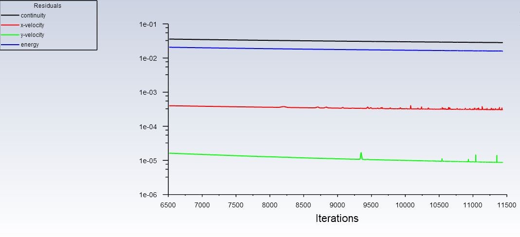

SubscriberDid as you said, i think it converged slightly faster, the behavior tough is the same. After now 12000 it's basically leveled out. Mach-Nr in the middle of the jet/pore exit as well as net mass flow rate also leveled out proportional to the residuals - they just dropped on a nice curve. Mach-Nr. is about 0.04 which is (even tough measurepoint is kinda little "much to the left") much lower than expected. Net mass flow between inlet and outlet is surprisingly negative - its really small tough (e-11) but the domain is also really small.
Contour of velocity magnitude looks similar to the one posted above. I'm having a really hard time interpreting this behavior. Is there anything else I could try or another angle I could work on? Thank you very much for all the tips so far!

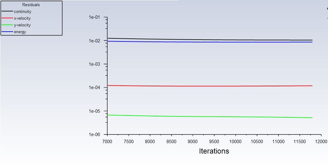

SubscriberSorry, i should've been more technical. After 12000 iterations there is nearly no change in the residuals anymore.

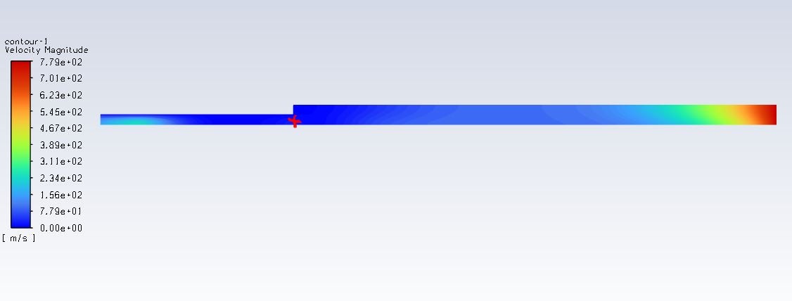

The velocity magnitude contour looks like this. I should mention that the pressure difference between inlet and outlet is per boundary condition 5bar.

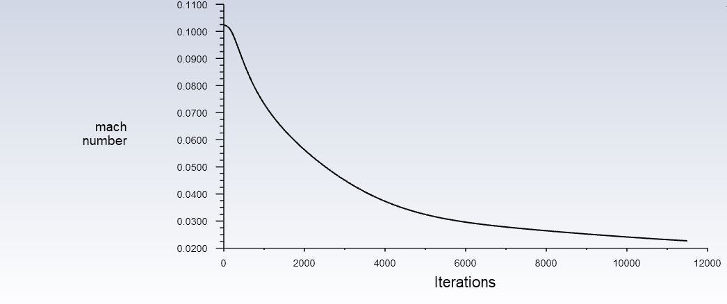

The red mark is exactly in the middle of the exit of the pore/jet and marks the point at which the Mach-Nr. for the following graph was taken. I expect there to be at least a few Mach-diamonds - so the max Mach-Nr. is probably not at the point of the mark (the point is a little to the left to where the max Mach-Nr. is supposed to be); still, the Mach-Nr. is much too low.

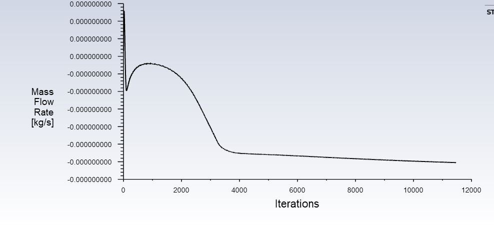

The following is the net flow of inlet and outlet over the iterations, it's approx. -1.5e-10. (fluent says inlet is 4.22e-11 outlet is -1.9e-10 ).
