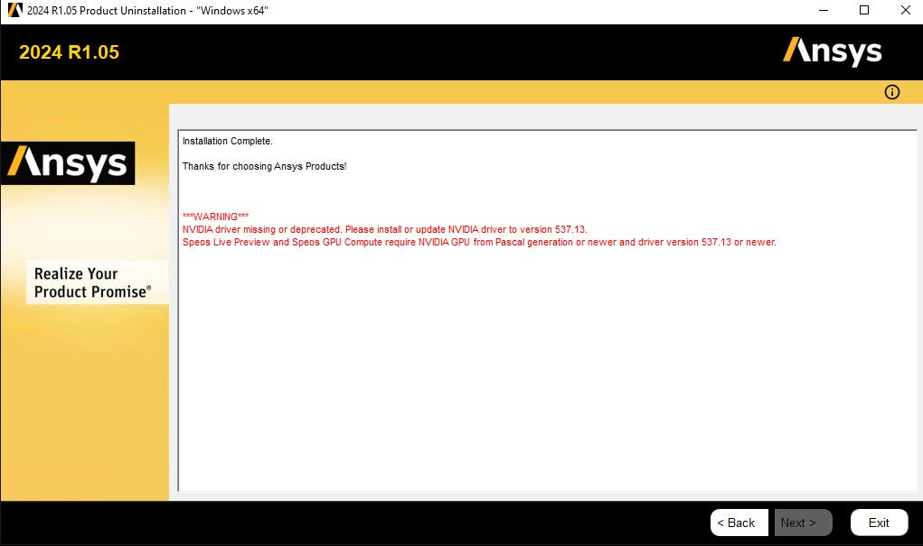

      The "c:\Program Files\ANSYS Inc\v241\Uninstall.exe"  command launches the "2024 R1.05 Product Uninstallation" window, but it is empty (no options to select products) and after clicking "Next" it ends with the message "Installation complete" (!?). How to uninstall ANSYS correctly in this case?

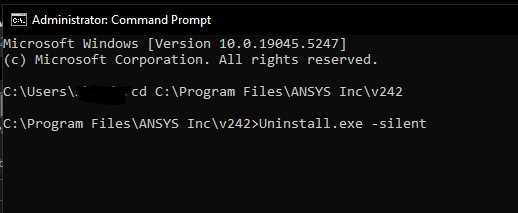

      Can you please go to 'c:\Program Files\ANSYS Inc\v241' then open a command prompt, use the command: Uninstall.exe -silent
      Once done, give it some time so that it can uninstall the application.
      Example:
      Note: This will uninstall all 2024 R1 applications under 'c:\Program Files\ANSYS Inc\v241'.
