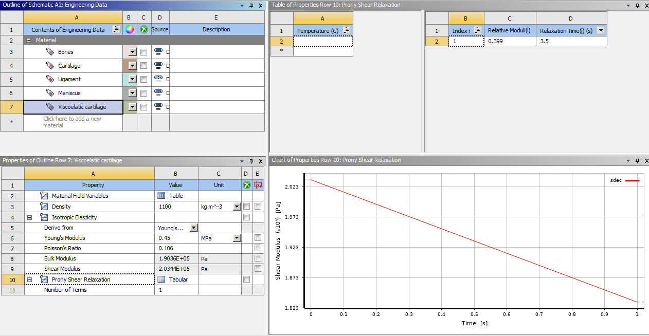

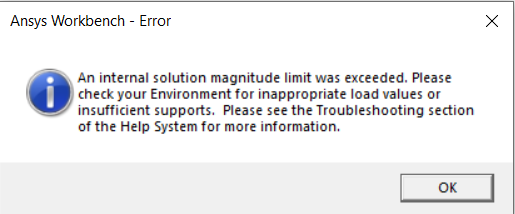

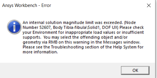

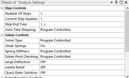

      I am having issues being able to successfully get results when modelling a knee model with specific parts as viscoelastic materials, namely the femoral and tibial cartilages. I am using tetrahedrons. I've tried adding weak springs, changing contact stiffness, adding large deformation, but nothing I do seems to be working. I keep getting the error "An internal solution magnitude limit was exceeded.", so I've also tried adding the command "ncnv, ,1e30" but unfortunately to no avail.

      The error might have been raised due to improper constraints or boundary conditions especially inappropriate loads or insufficient constraints, so a check on boundary conditions might help resolve the issue.
      For the cases where there are no supports required, try considering 'Weak Springs' and if considered and still facing the issue, try updating the stiffness of the same. Using 'Inertia relief' might also work for such cases.

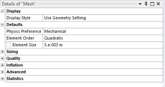

      Apart from these, selecting an appropriate mesh size helps to give accurate results, the following video might also be useful for the same.
      Specifying an Appropriate Element Size for Stress Analysis — Lesson 1 - ANSYS Innovation Courses
