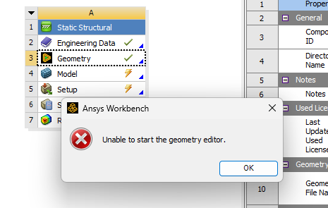

      I just installed ANSYS 2025R1 (Student Version) on my computer and I get this error message when I try to open the geometry.
      I have already tried all these actions without success:
      - Rename or delete the appdata and temp folders.
      - Remove all registry information related to ANSYS.
      - Uninstall and reinstall the tool.
      - Install a previous version of the tool.
      - Run Product & CAD Configuration.
      - Check that the tool has permissions to bypass the computer's firewall.
      - Update the graphics card drivers.
      The model I am trying to open does open correctly on another computer that I have just installed as well.
      I can't think of any other actions and I haven't found any more information on the internet.

       1 - The logs files in the %TEMP%\WorkbenchLogs directory have the following text:
      Event log opened 31/01/2025 19:33:10 Hora estándar romance
      Product version: 2025 R1
      Build version: 25.1.0.0
      {31/01/2025 19:33:32} [ProjectReplaced:Project] A new project has been created.
      {31/01/2025 19:33:40} [ProjectReplaced:Project] The project has been opened from C:\Users\[USER_NAME]\AppData\Local\Temp\Bolted Nozzle Flange.tmp\Bolted Nozzle Flange.wbpj.
      {31/01/2025 19:36:36} [GeomEditorTimeOut:DMAddin] Unable to start the geometry editor.
      2 - The install.log file, don't list any errors.
      3 - I cheked the Windows System Events but didin't found nothing.

      Today I discovered the solution:
      I had to go to I had to go to “Turn Windows features on or off” and enable: ".NET Framework 3.5"
