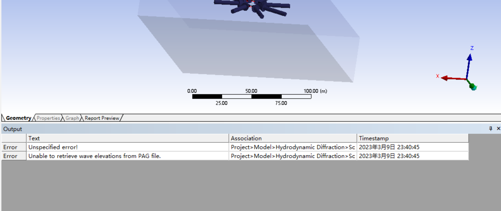

Unable to retrieve wave elevations from PAG file.

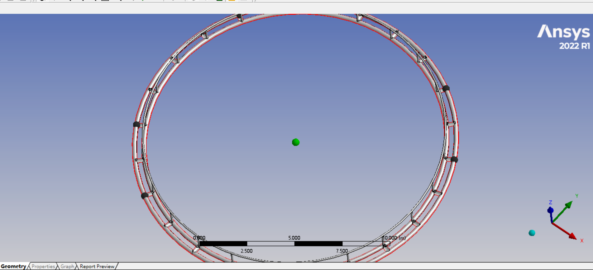

      • Are you able to provide a screenshot or description of the model that you are trying to analyse? - does it include Surface Bodies (panels) and/or Line Bodies (beams)?

    • å¿— 王
      1 2022 R2
      2 follow a screenshot
      3 turn off the 'Generate Wave Grid Pressures' ,don't get the result of pressures and motions ,other result  COMPLETED SUCCESSFULLY.
