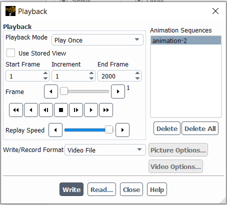

Im using fluent 2021 R2 version. When Im trying to obtain animation via hsf files, Im able to modify the settings for the picture by using the 'Picture Options' but not able to modify the video settings using the 'Video Options'. In the below image, even though I have giving setting for the Write/Record Format as video file, still the video options is not enabled. Im using .cxa file to obtain the animation and the storage type is .hsf files
Thanks in advance.Â

Ansys EmployeeI assume you are using an academic license and there the options due to loyalities are not included.

SubscriberMany thanks for the text. Yes - Im using academic license. Thanks.

Ansys EmployeeWelcome! That should be documented in the next release version. You have many possiblities to create animations when having rastered pictures in PNG format as example (like ffmpeg or if you have Ansys EnSight to use EnVe).
