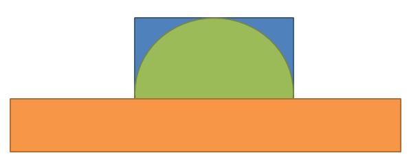

SubscriberPeter i was able to generate the mesh with applying clean bodies operation and changing the mesh settings.But i have a doubt.actually i made two helmets one with the reinforcement ribs as circular cross section and one with rectangular cross section.i checked both for a drop test and i got deformation identical in both cases.i got 0.37 for rectangular ribs and .35 for circular ribs using ABS as material.which is better to use a rib with rectangular cross section or a circular one.i think rectangular section have good section modulus but in ansys d results were differed.pls guide more on this

Subscribercould you further eleborate a little more.Actually when i change the mesh setting from curvature to fixed to proximity and various settings i saw the mesh was unable to generate most of the times so i resorted to proximity only.what step do i need to do?Kindly guide me
Do u have any idea based on physics which cross section has least chances to deform circular or rectangular so that i can validate my ansys results if its right or not?
September 1, 2018 at 11:23 am
peteroznewman
SubscriberIf the circle is inside the rectangle, then there is less material, so a physics argument is that it should take less force to deform the circle than the rectangle.
If you get two successful meshes on the same geometry, and one has an edge length of 1.5 mm and the other has an edge length of 1.0 mm, if the deformation remains at 0.35, then that is evidence of a mesh-independent result. If you repeat for the other geometry and that value doesn't change for two successful meshes, then you can conclude that there is a difference between the geometries.
Ideally, you would also create a mesh with an element edge length of 0.75 mm and a coarse mesh of element edge length of 2.25 mm. Then you would have four points to plot the result vs. edge length and see if the value has converged on the exact value. See this discussion.
September 1, 2018 at 1:45 pm
KumarVaibhav
Subscriberok got your point.will do iterations then
but tell me about the physics argument.What do u mean when you say the circle is inside the rectangle?
do u mean to say the skeleton ribs with(represented inside the helmet as crossed line body kind of) rectangular cross section is less deformable to the drop test i am interested in than over the ribs having circular cross section?i wanna validate it with ansys so pls elaborate more on the physics argument and how to cross check with ansys,it would be great learning for me
