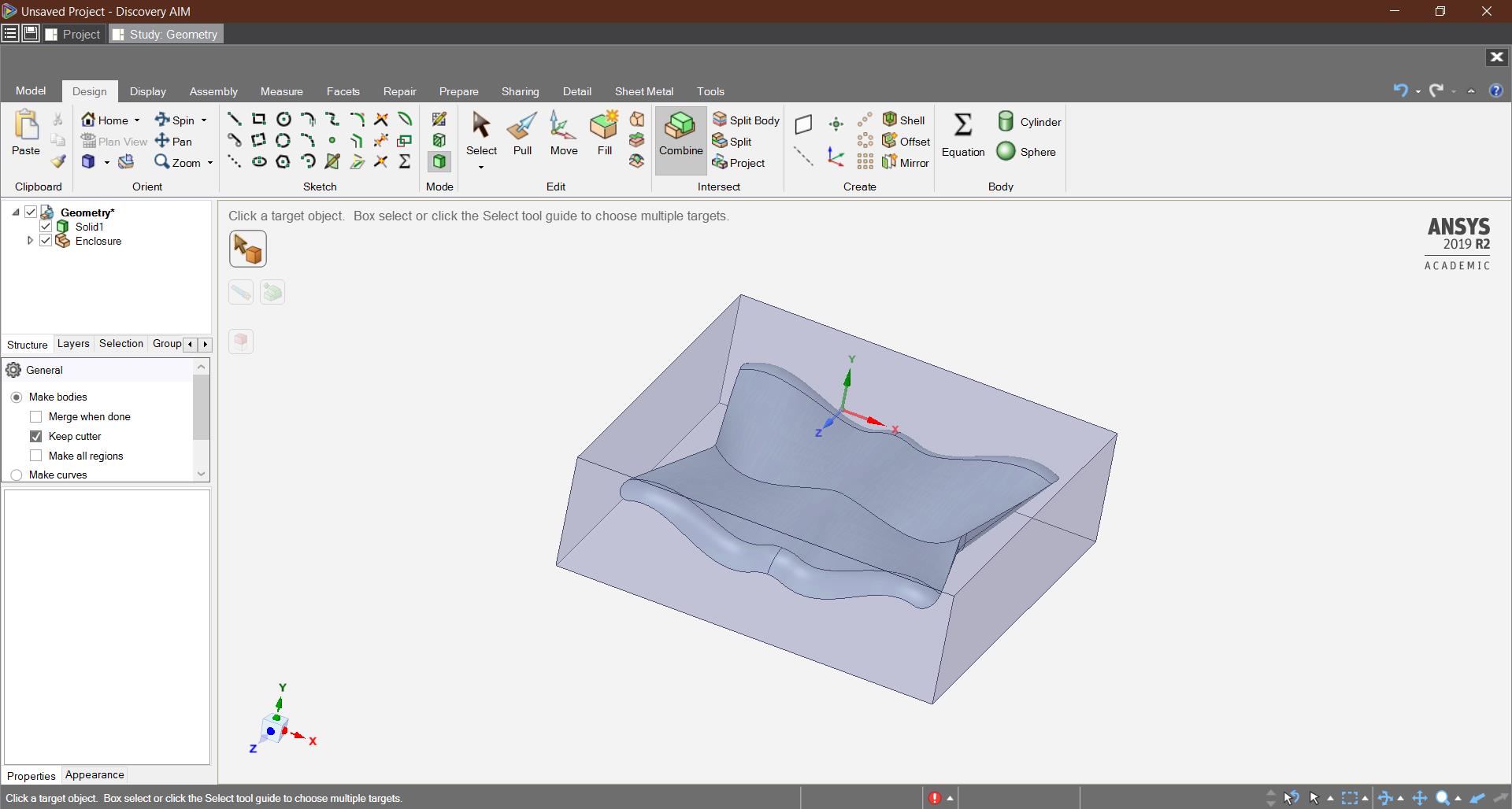

The successful enclosure has already subtracted the solid. Open the Enclosure item in the structure tree to see it.
Combine is failing because there is no intersection.
