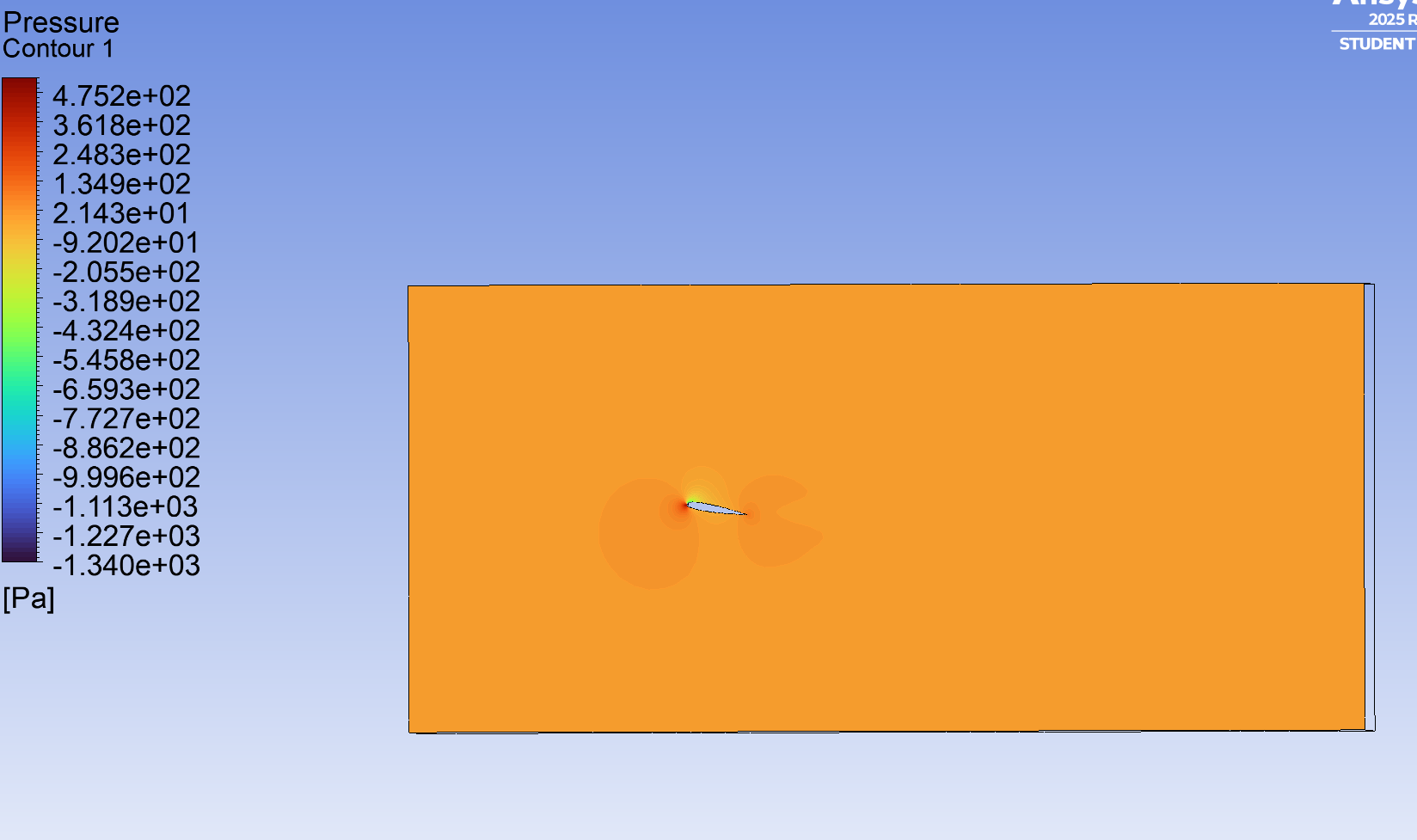

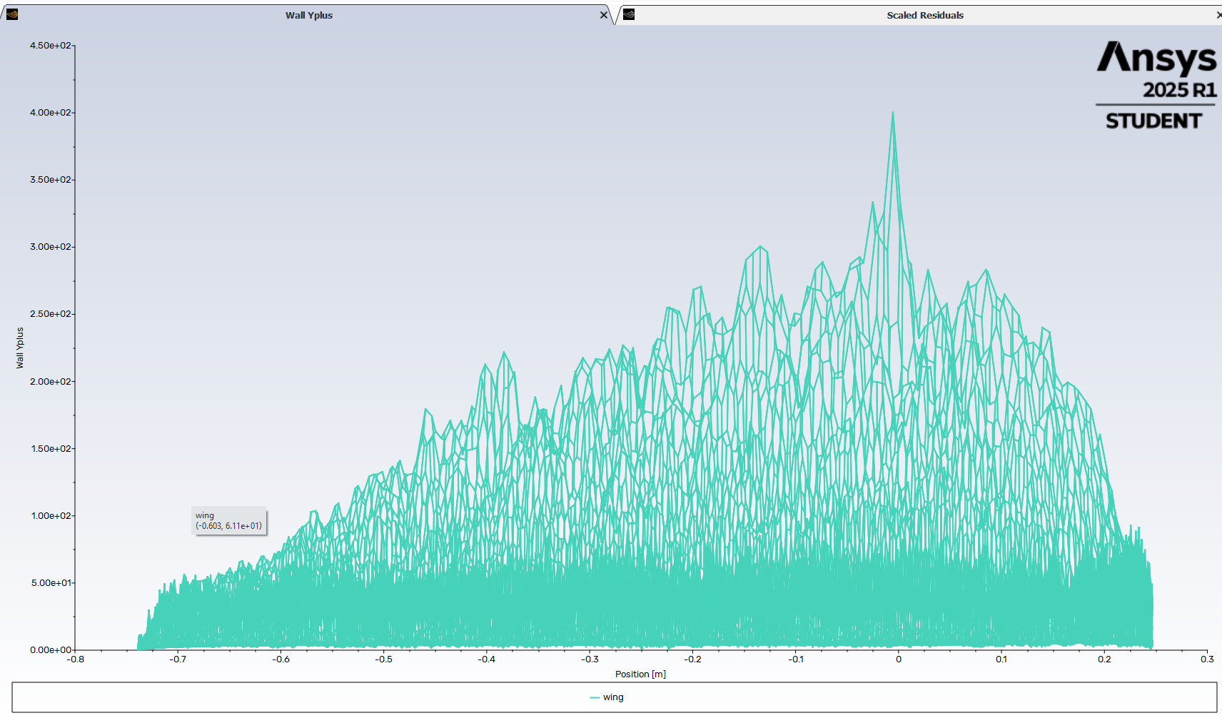

      I am simulating the Naca 0012h airfoil at many AOAs, for now just 10 degrees. I am simulating both lift and drag, and getting the cl and cd from those values. However my Cl and Cd values are way of, i believe my Cl should be 1.2, however I am getting a value of .2. My fluid velocity is 30m/s, chord is 1m, and winspan is .5, however I am using symmetry. The lift value I am getting is around 27-29N, and with symmetry that makes 54-58N, which results in a low Cl. I am new to Ansys, and I have been looking at videos online to find different ways I can make my simulation better, but everytime I do change something, I still get the same lift values, I have tried Spalart alIarmas, Transition SSt, with y+ of around 1. appreciate any help!!.

      My boundary conditions are: inlet for the front which is velocity, outlet, in the back which is pressure, and then the side with the airfoil as symmetry, and the top, bottom, and other side wall as wall. I just watched another video, and saw the person make all the walls, top bottom, and side, as symmetry, so I will try that now. Thank you for your help !!

      So my previous attempt did not work, however i tried again with transition SST, and got a much higher lift force of 56 N, with symmetry so total would be 112N. However this results in a Cl of .4, which is still less than half of what this should be, I read that for these types of tests done by actual organizations, the wings span the entire domain, so i will try that next.
      Also look at the pressure on the top and bottom surfaces. You may need to adjust the range to see a peak somewhere around the blades. Then read up on wind tunnels and why they're calibrated.

      Hi Mr, Rob, I read about why wind tunnels are calibrated, and what I found was they are calibrated to compensate for the small errors that form due to the wind tunnel. So are you saying i should change my settings to compensate the errors formed by things such as my boundaries, etc.? Also Here is a picture of my pressure.
