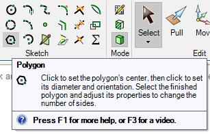

      It appears to be a pentagon or hexagon after I chose to sketch a circle.
      can someone help me with this ? how to change the resolution of circle ?
      Thanks.
      Stop clicking on the Polygon tool at the bottom, and start clicking on the circle tool at the top or middle.
    • jiantiong
      Yes, I clicked on the circle tool and sketch the circle on the plane but it appeared to be a pentagon.
      Please save the scdoc file and attach it to your reply and I will take a look at it.

    • lokeshkalamalla
      Click on File->SpaceClaim Options, look for Graphic performance options and set rendering quality to a value(1-6) and set default
