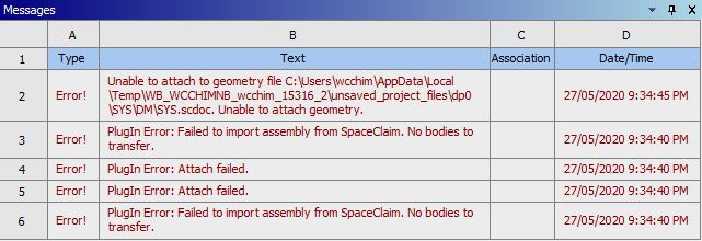

    • Chim6120
      Hi Aniket,
      Below is error message too.

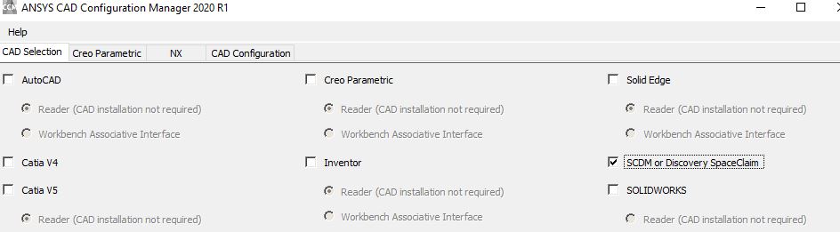

    • Chim6120
      Hi Aniket,
      I have even tried to click 'SCDM or Discovery SpaceClaim' in CAD Config Manager. Yet still failed.

    • Aniket
      Are you able to import a simple cube created in SpaceClaim to Mechanical? Error there says no valid bodies, what do you see in SpaceClaim?

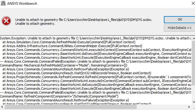

    • Chim6120
      Hi Aniket,
      Thank you for your reply.
      Actually I was trying to import 2D rectangle body from SpaceClaim to Mechanical, but failed. It shows error message as such.
      Please advise.

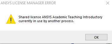

    • Aniket
      It seems like you don't have an available license. It is possible that you had your original model open while trying a 2D rectangle. Close all workbench sessions. (restart your machine if possible) And then try the 2D rectangle body.

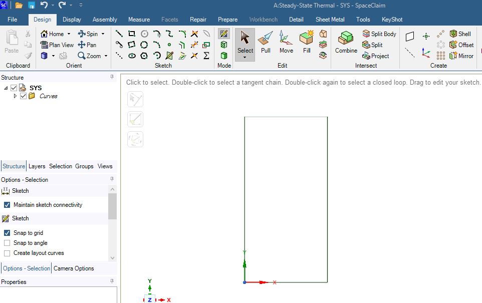

    • Chim6120
      Hi Aniket,
      Below is screenshot of SpaceClaim window of my actual geometry.

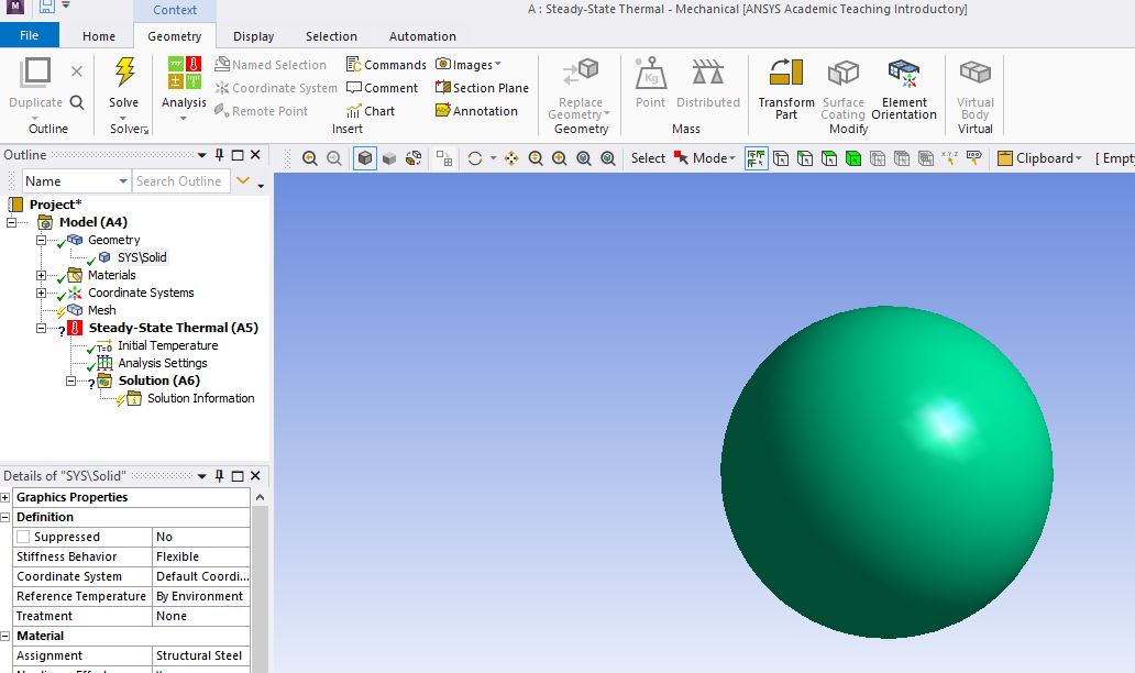

    • Chim6120
      Hi Aniket,
      Surprisingly I can import simple 3D in Mechanical. Refer to attached picture below. However it doesn't work for 2D.

    • Aniket
      You don't have a body in SpaceClaim you only have curves. Select all curves and use "Fill" tool to create a surface. that should come through.
    • Chim6120
      Yes, Aniket.
      I managed to import the entity (surface) to Mechanical now. It's solved.
